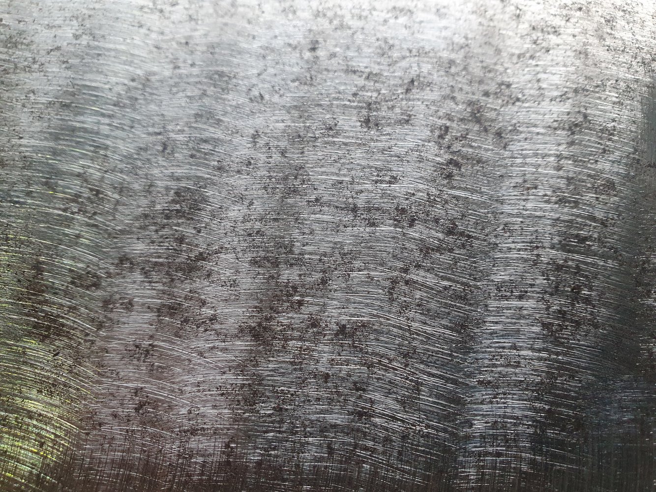

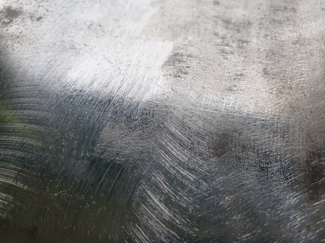

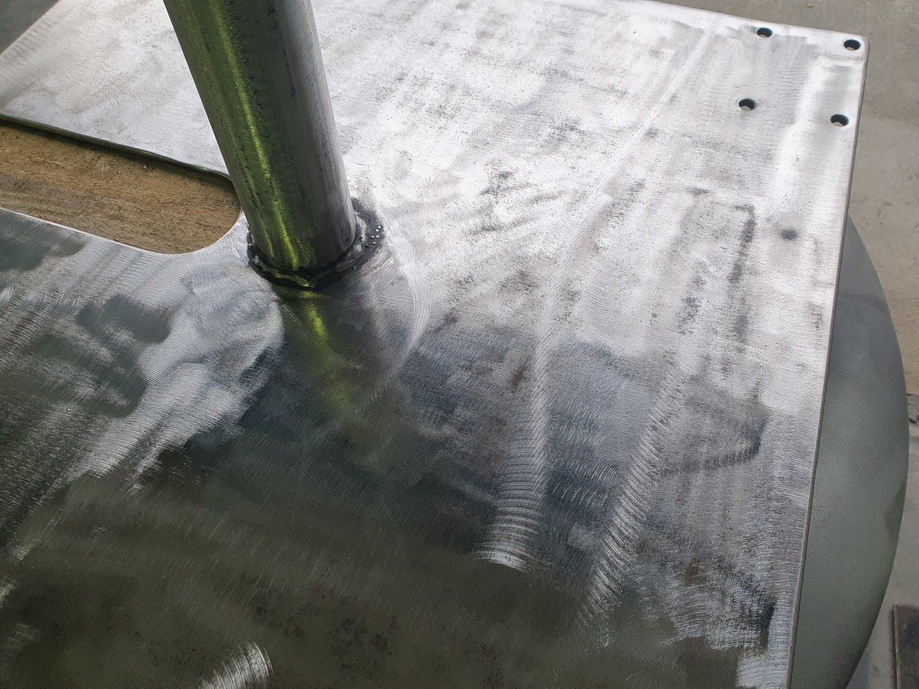

Evening all,
Just a quick question for you. As title really... but I'm at my wits end with this stuff ever since my job peelee after polishing some of surface with a non woven disc, resting in flaking.
So I'm just about to spray some plate for a friend. What I've done is prepared the surface with fresh 40 grit Disc on grinder. Then to clean surface its Upol slow drying degreaser.
How does this sound to you? The pictures so the surface fairly scored up albeit at a more microscopic level. Would that be sufficient to make it ST2 ISO surface prep grade ?
Thanks a lot guys
P.S. I know blasting is best and I have all that gear...but life is too short as I don't have a suitable environment.
