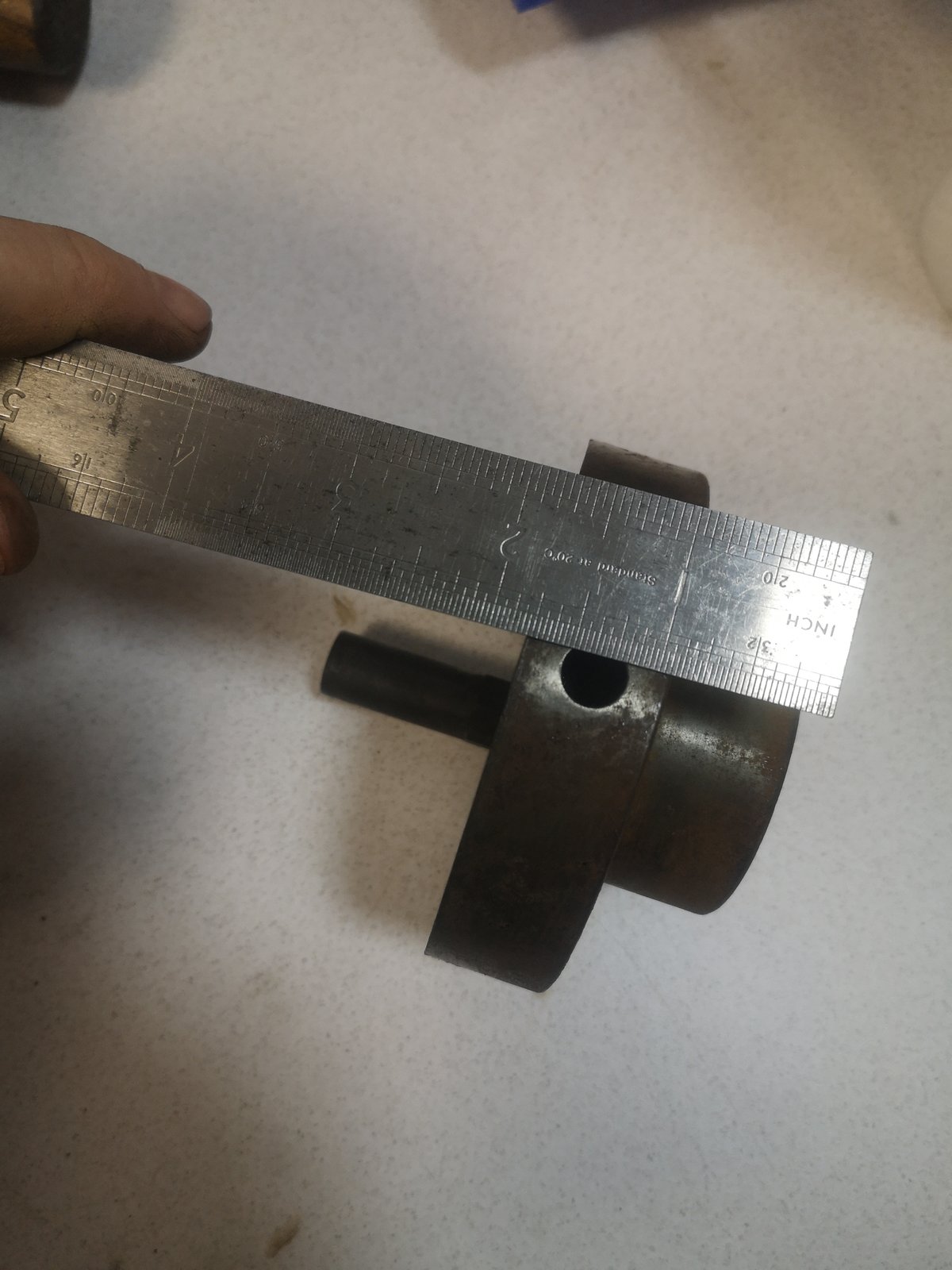

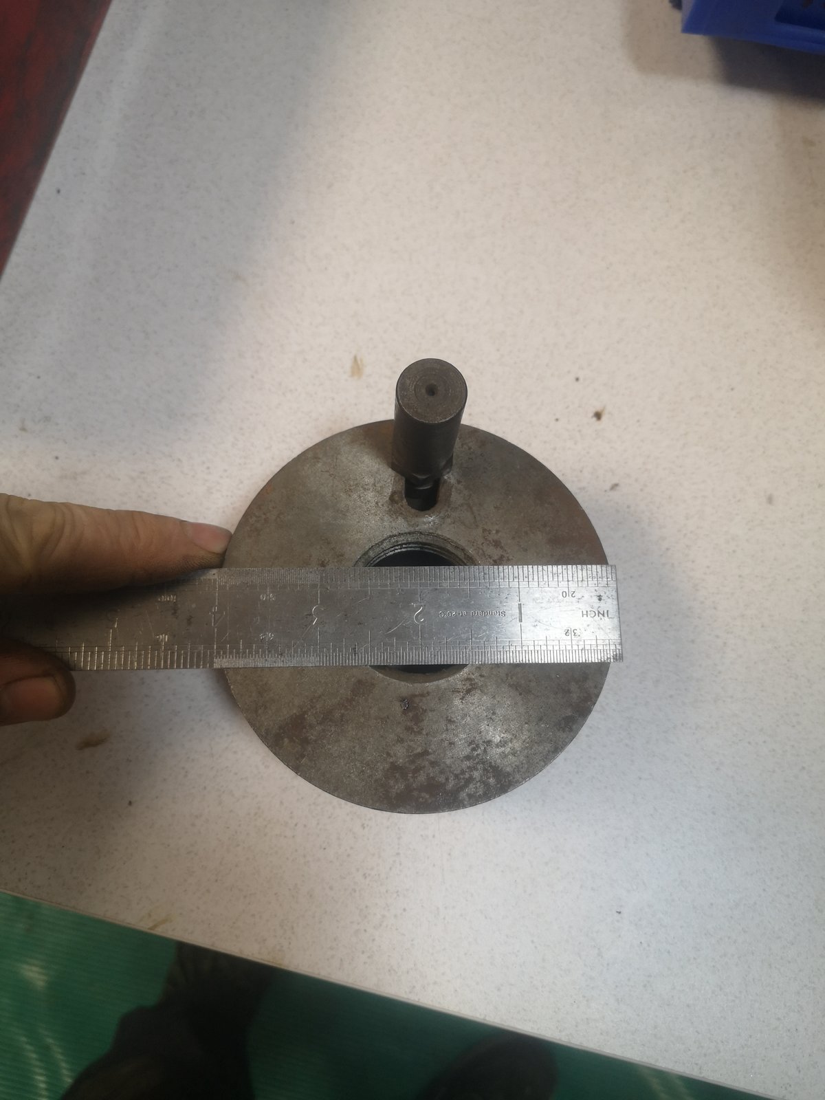

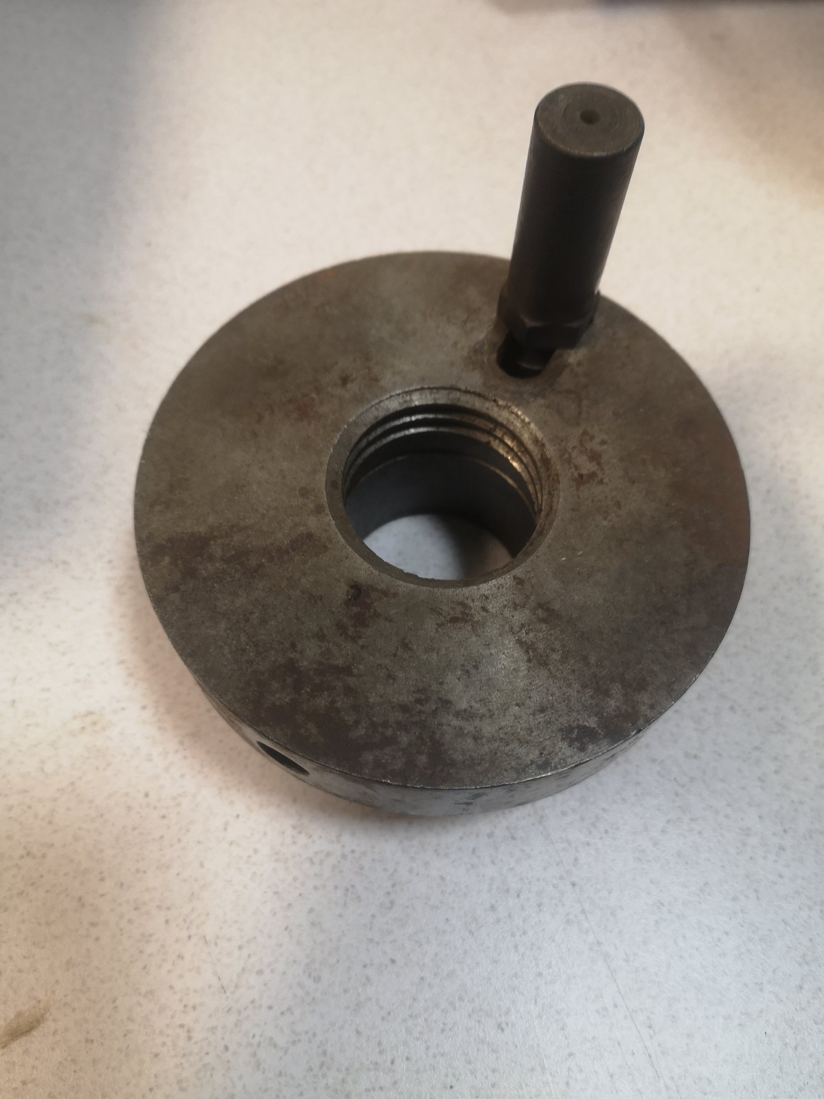

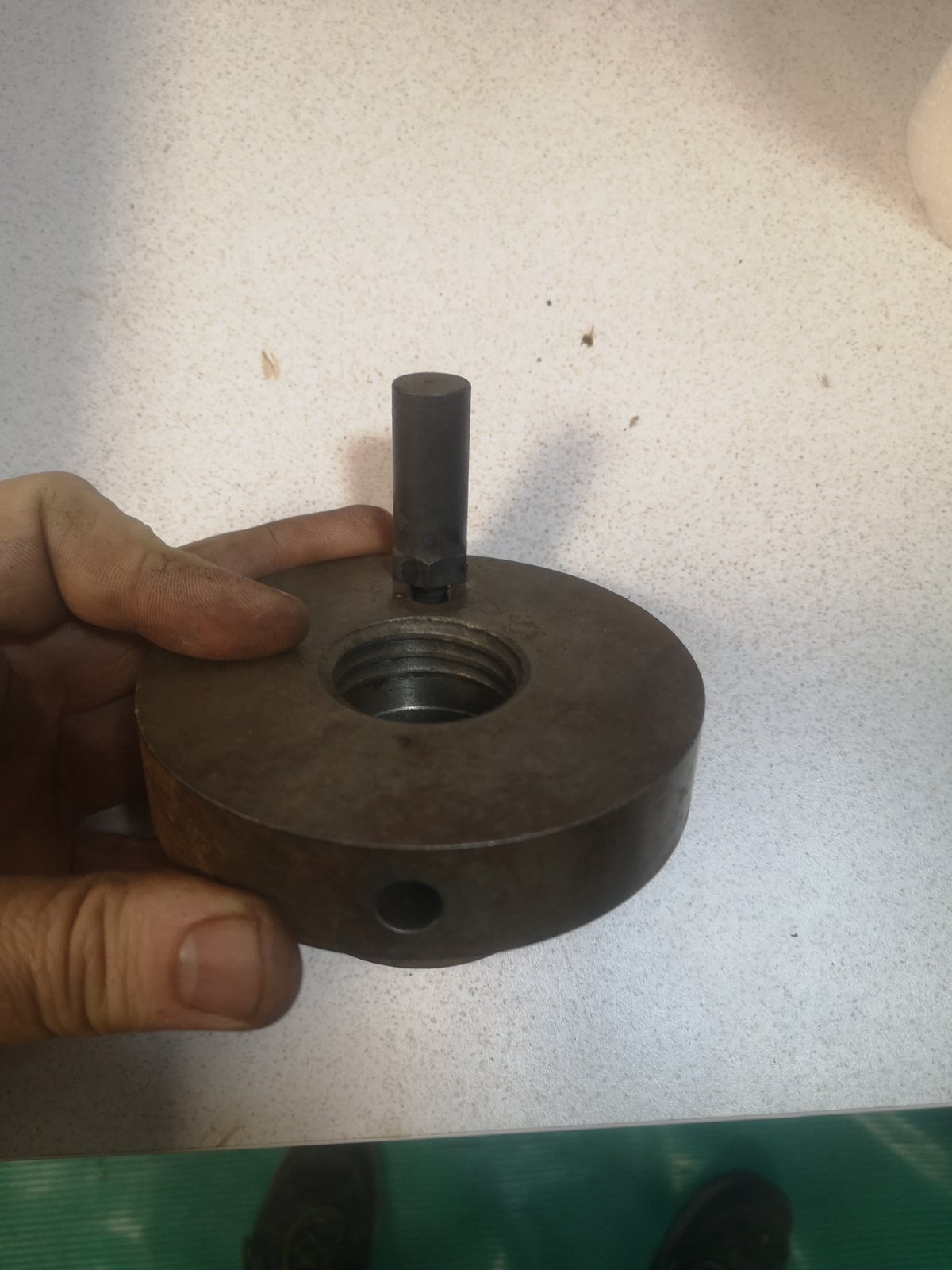

Milkybars Member Messages 1,230 Location Essex Dec 5, 2020 #1 1 3/8" x 6tpi Trying to find out what lathe / machine uses this thread, must be of use to someone ?? IMG_20201202_203800.jpg 180.9 KB · Views: 39 IMG_20201202_203812.jpg 204.4 KB · Views: 46 IMG_20201202_203829.jpg 191.9 KB · Views: 38 IMG_20201202_203846.jpg 177.6 KB · Views: 41

mtt.tr Member Messages 8,471 Location Essex/Suffolk border Dec 6, 2020 #3 I think i have a small 4jaw with that thread came from a wood worker
A Agroshield Member Messages 6,068 Dec 6, 2020 #5 After your tip off about Wadkin, I found a reference that said the BZL had the same nose thread. The brochure for that does show 3- and 4-jaw chucks. https://www.wadkin.com/wadkin-bzl-lathe
