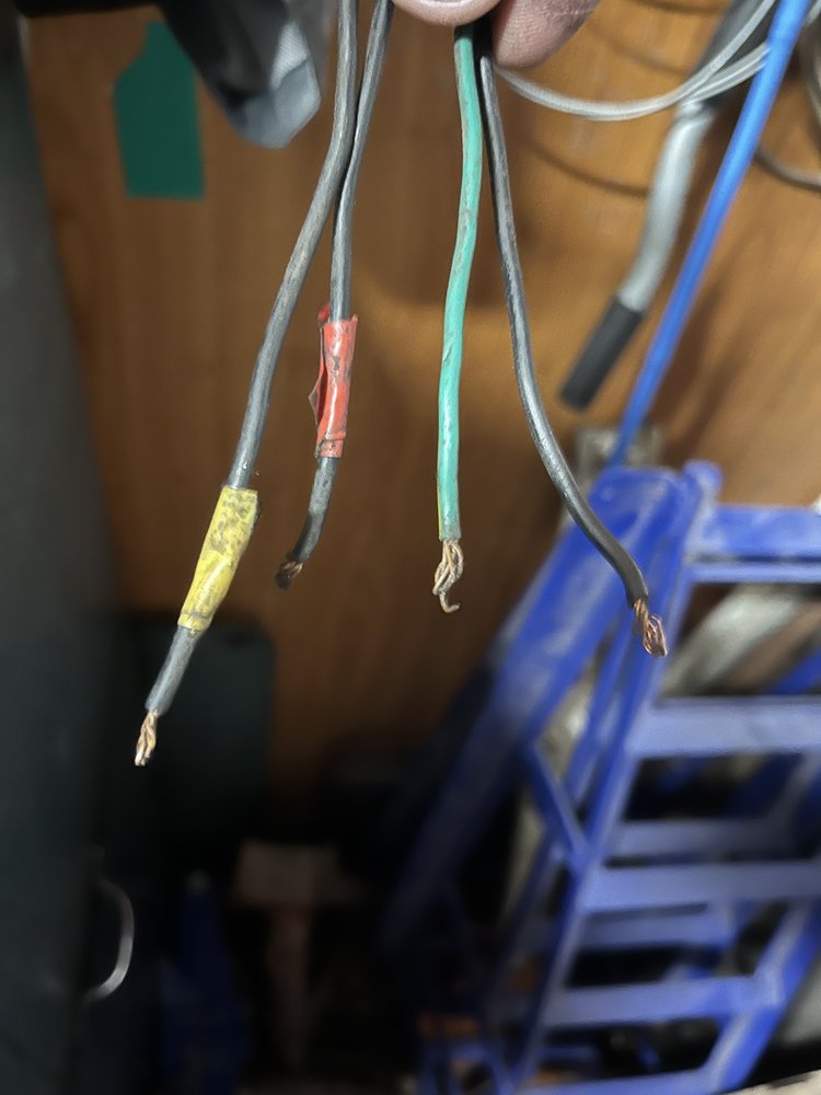

most youngsters wouldnt know how bell it out was named or what it is years ago most firms only had 1 megger and an avo meter to test they gave everone else a doorbell and a battery with leads fitted if you got the right leads end to end or a circuit the bell rang was often used on making pyro cables up as the cores wernt marked up in the pot and you had to sleeve the live when you found itGet a photo of motor or contactor connections then bell them back to the cables in your hand.
