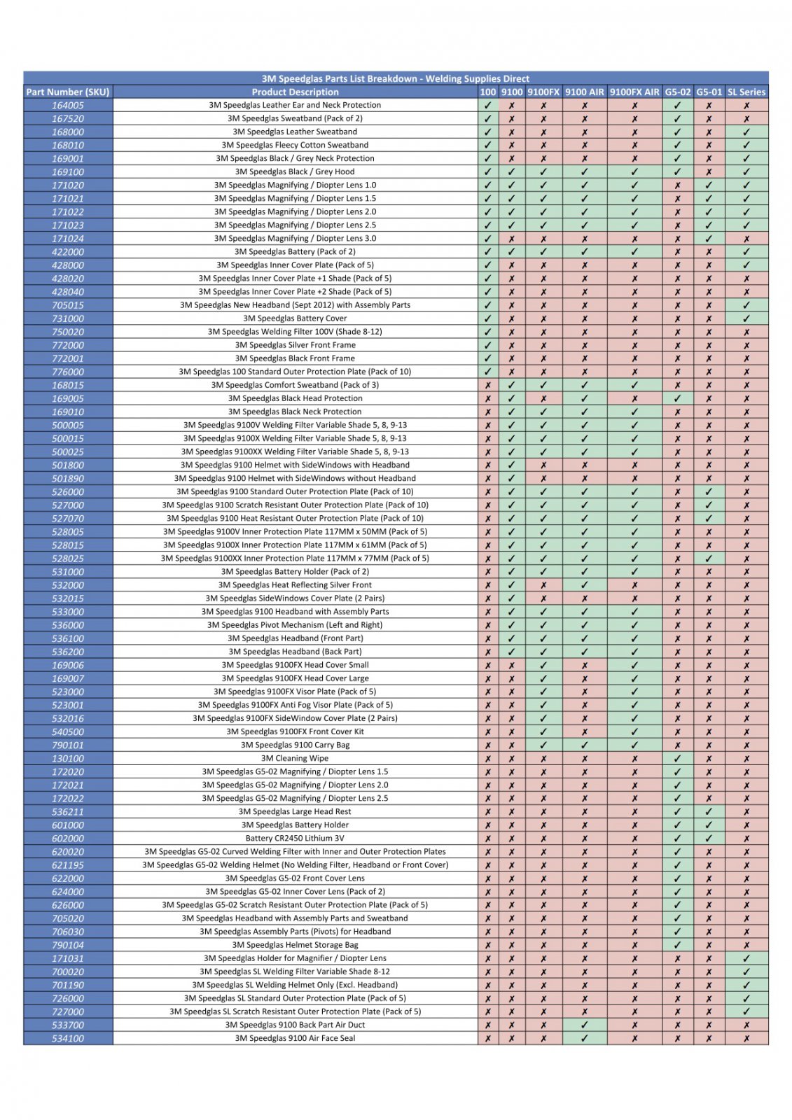

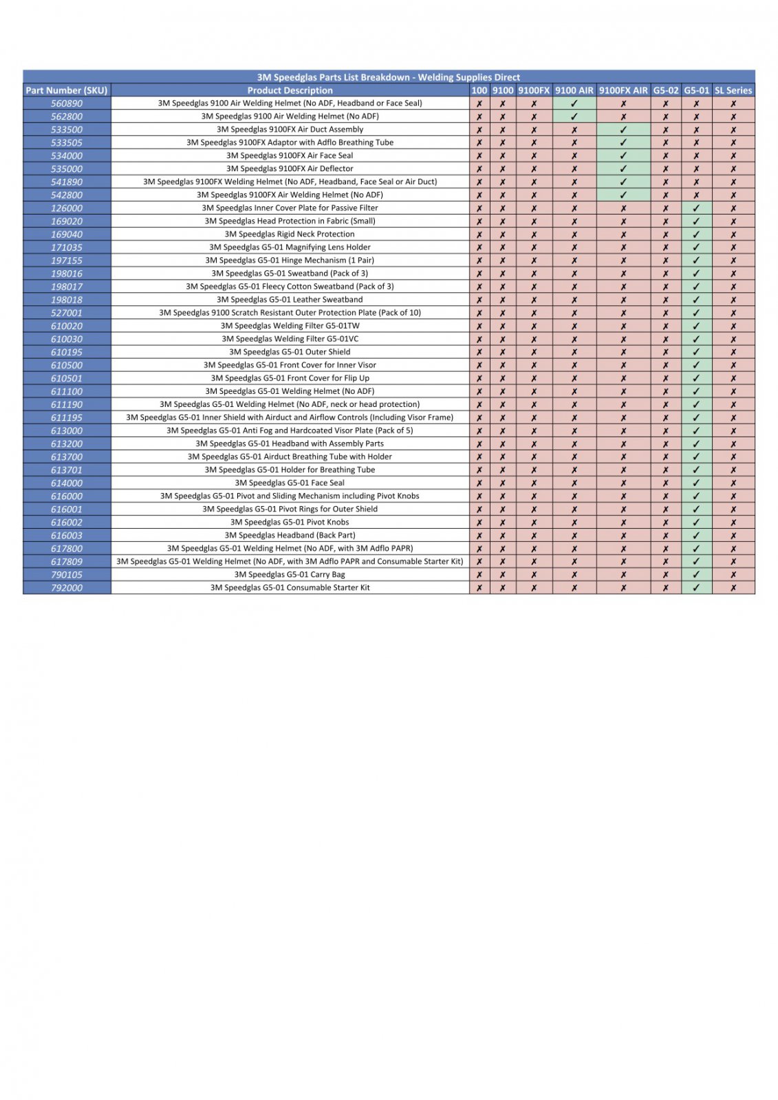

Hi all! I hope everyone is doing well
I thought this may be worth posting here as a bit of a reference. Its something i've been working on at work for some of the staff to know which 3M speedglas parts work with which 3M speedglas helmets because there can occasionally be a bit of crossover with part numbers etc.. I've listed the part number, part description and then listed the various commonly used helmets across the top; if theres a tick and the box is green its suitable for use with that helmet, if theres a X and its red then its not. Pretty self explanatory.. you get the gist.
Either way, it may or may not be useful, I thought it worth posting either way. Let me know if theres any changes you could recommend and i'll implement them.
Cheers guys!
