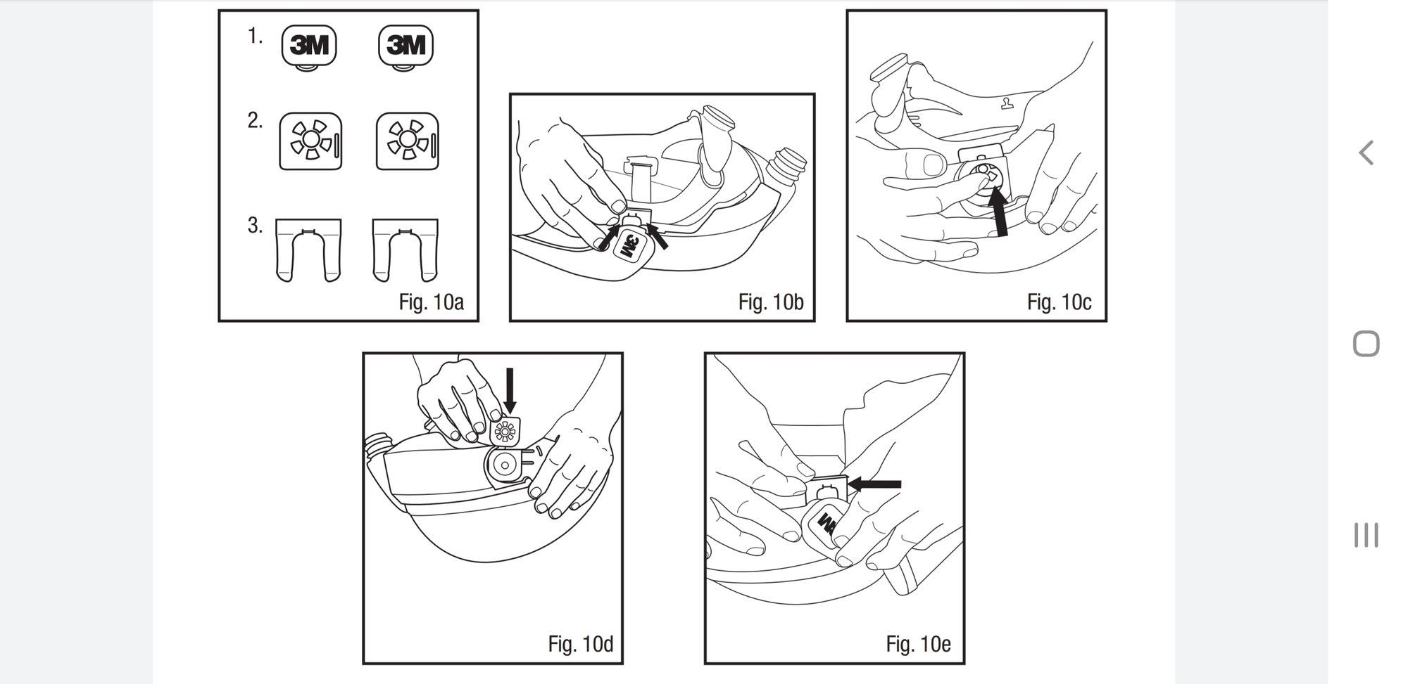

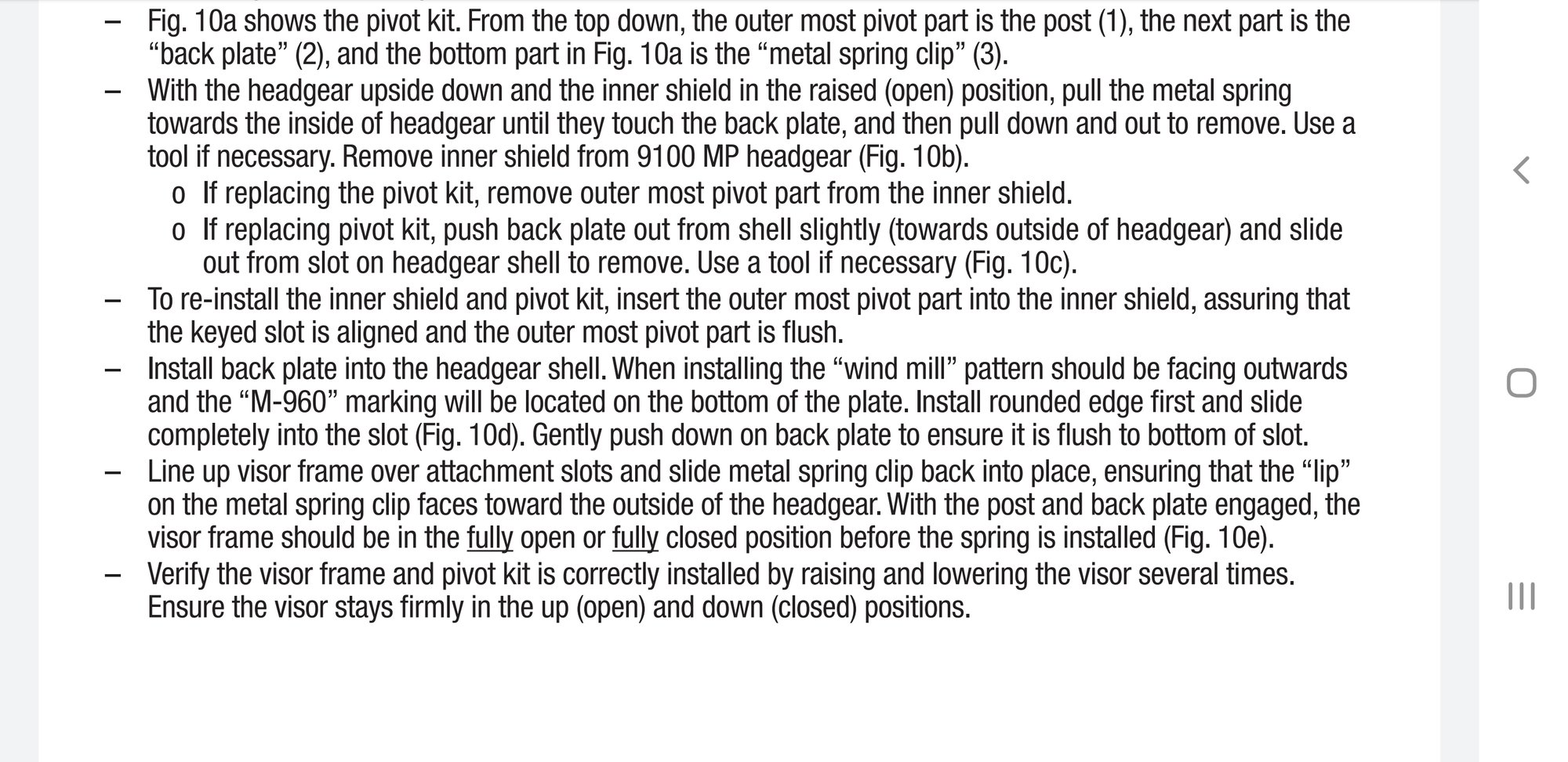

3M Speedglas 9100 mp won't stay up, no tension adjustment on the sides? Anyone have any experience of this or knowledge of any fixes? Seems a bit wierd it lifts but won't hardly stay up at all. There are two spring clips that dictate the tension but no way to adjust.
Bit disappointing given the cost! Constantly walking about on eggshells to stop it falling down!
