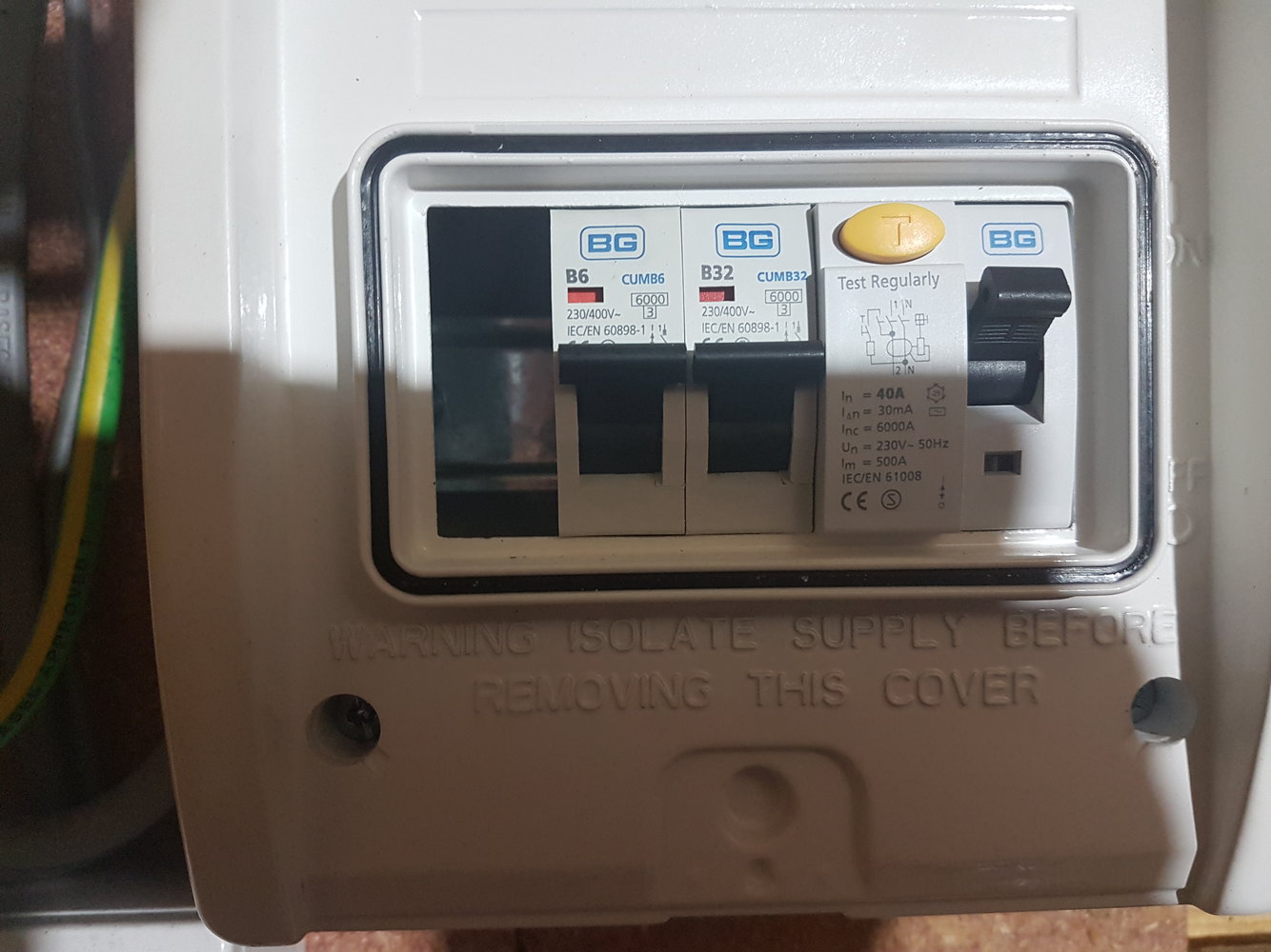

hi thanks, would this be simple for an electrician, as said i aint got a clueput a 32 amp mcb in the spare slot and run some 4 or 6.0mm cable to the socket from it job done
many thanksYes very simple for an electrician to sort out!![]()

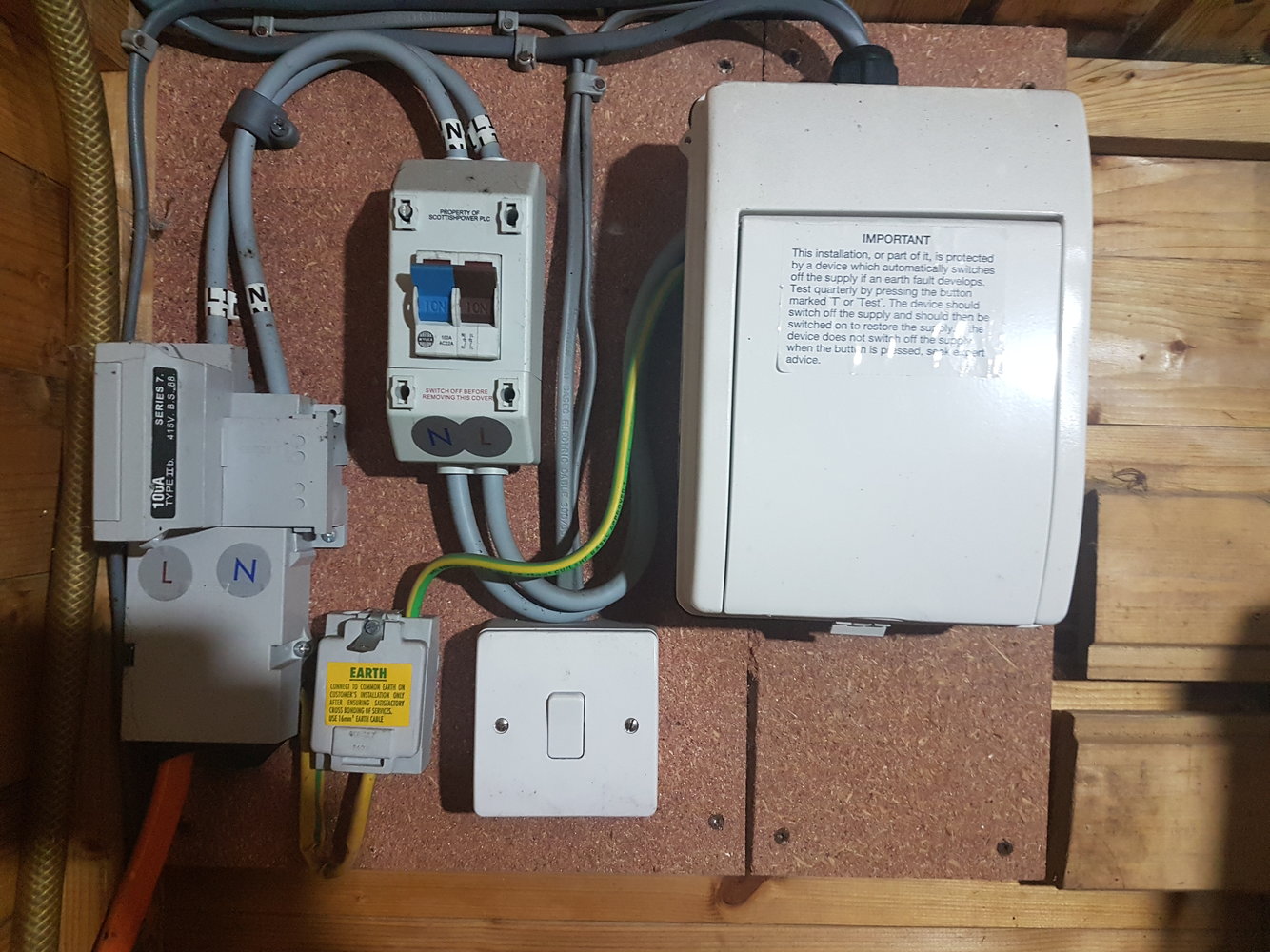

looks like his garage supply, meter in the house.No meter?
With a DNO service head?looks like his garage supply, meter in the house.
With a DNO service head?![]()
you can buy the henley cutout might be a sub main from the house and as aboveWith a DNO service head?![]()
Might be..but with N and L tapes on the tails/stickers that's a pro install.you can buy the henley cutout might be a sub main from the house and as above![]()
leccyboard electrician doin work on the sideMight be..but with N and L tapes on the tails that's a pro install.
