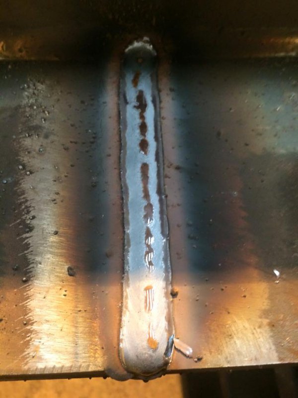

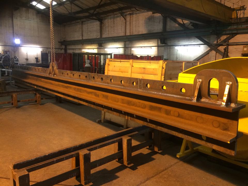

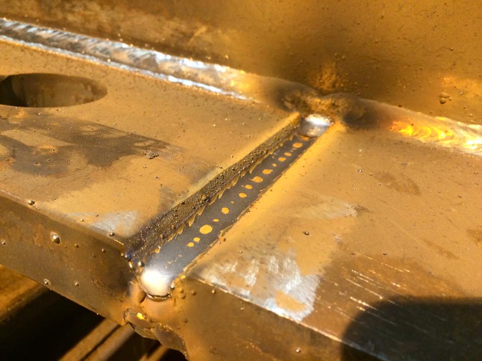

As seen on my acid etch thread I'm currently making some hefty lifting beams.
I thought this was a decent opportunity to show, pictorially, how to build up heavy butt welds.

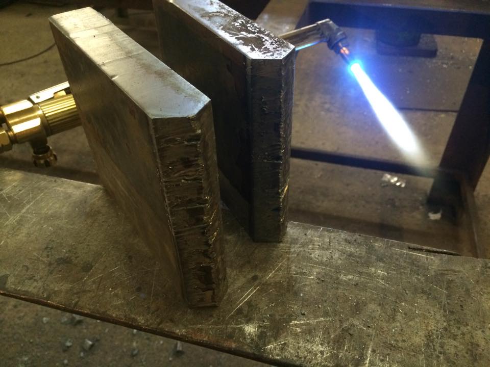

The photos show a double 'V' joint of combined 60 degree prep with roughly a 2mm root face and 2mm root gap. I say roughly because this is a job in real time so they've been gas cut by hand and quickly ground up. They are not perfect and I've not run test before to get every setting exact, in industry when you're doing this day in day out you get one crack at it. This isn't a college exercise so my settings were pulled out of my head from experience, quick blast on scrap to check it's ok and away we go.

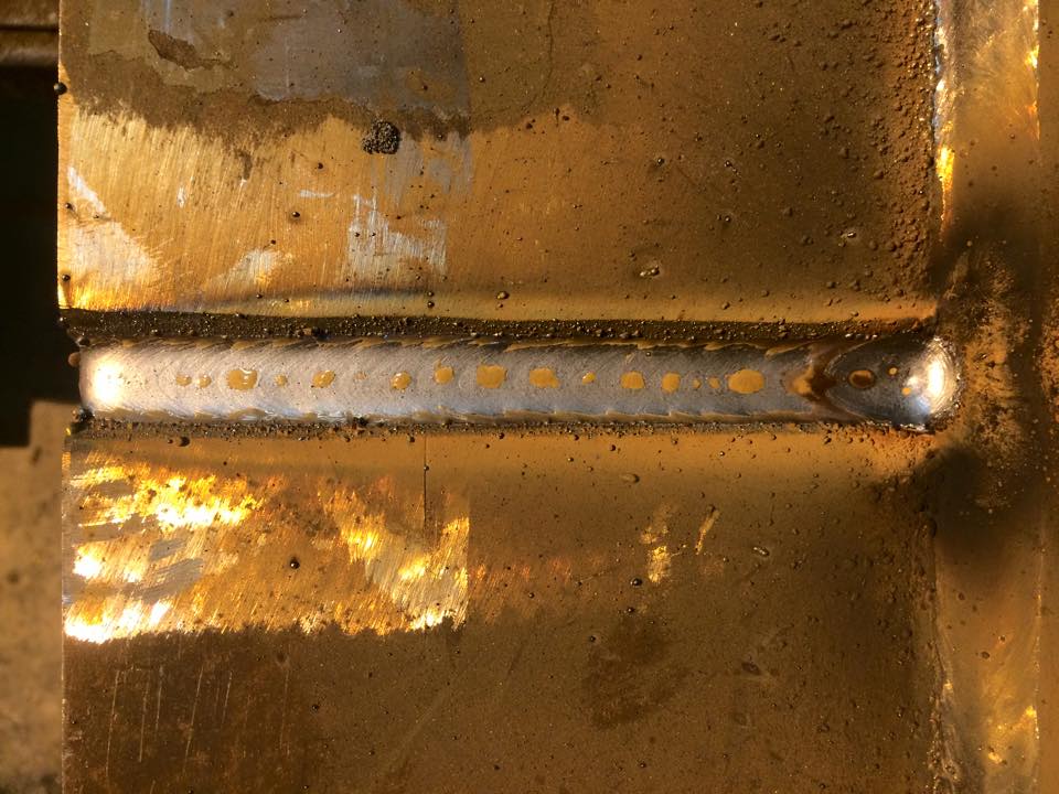

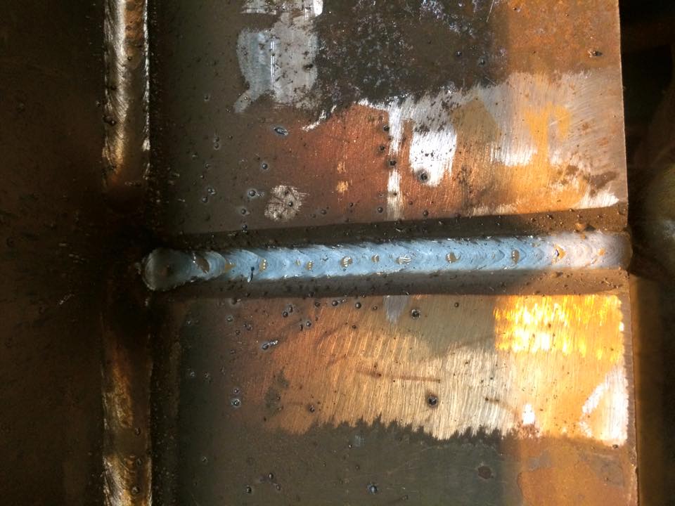

So, to start, I place a light-ish root run. I'm running at about 28V with 1.2mm wire running at around 12 M/min. I'm erring on the side of caution here. Since it's a double 'V', I'd rather my root to be a tad light rather than too much and then burning through, requiring remedial work. If this were a single 'V' I probs would have ran a quick test piece to get it spot on, penetration-wise.

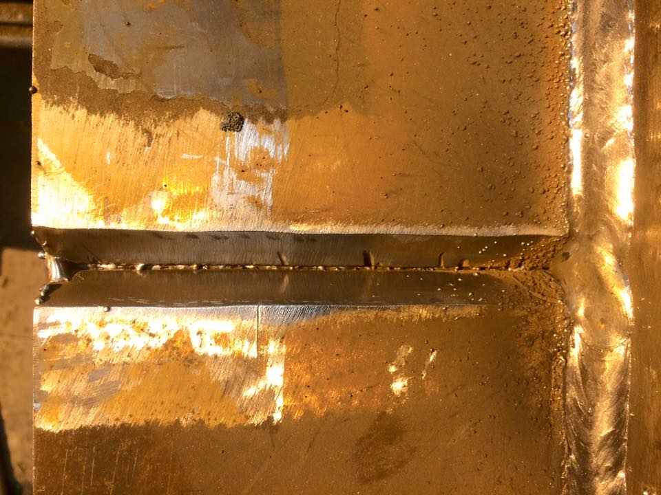

So, here's the first side root. 1st as welded, then cleaned up with a wire cup brush.
