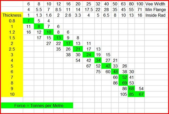

I have a 30 ton press and i am going to make up some folding tools for it
How thick and wide a sheet will i be able to fold
I was hoping to fold a sheet 500mm wide that is 3mm thick
Doable?
