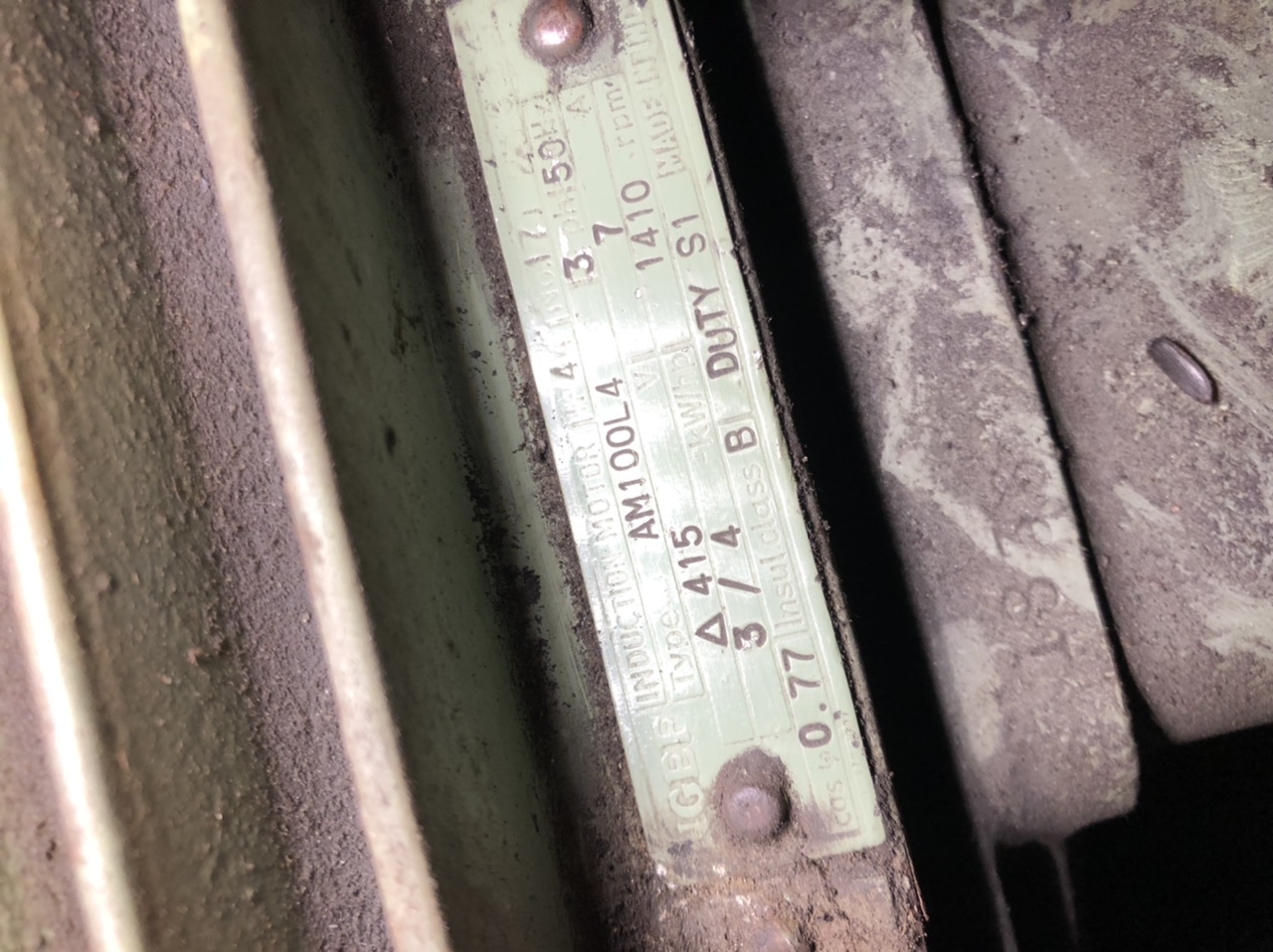

I have started this as I don’t want to derail Kim’s thread on the Colchester.
following her build I am going to bite the bullet and go down the VFD route. It’s a good mill and I’d rather keep what I have than buy something else.
Would a VFD run the attached motor does anyone know please? It’s delta 415v @ 3kw so I’d need a beefier drive than the one Kim had. Everything I have read suggests it’s not going to work as the motor needs to be 200v?
I (hopefully) stand to be corrected
this appears the same as @KimB has but bigger
It seems 220in/220out
