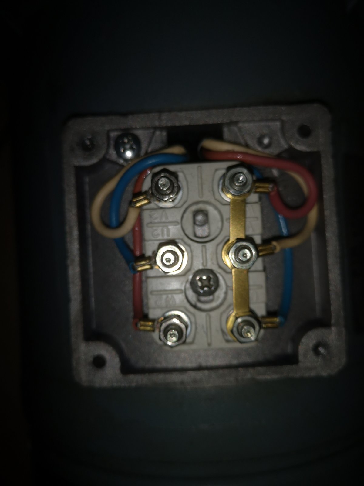

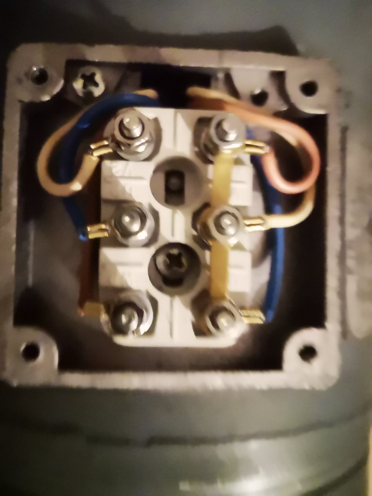

Ok, I've picked up a dual voltage 3 phase that's been bridged to star.
I need it as delta.
Easy, move tags 1,2 &3, job done.
I've tag 1
I've tag 2
I've no tag three and I can not for the life of me work out its name to hunt tag 3 on eBay... Any suggestions?
I need it as delta.
I've tag 1
I've tag 2
a bit of solid copper wire round the screws between brass washers
your gonna end up putting the feed to it with wire and possibly crimp on lugs
