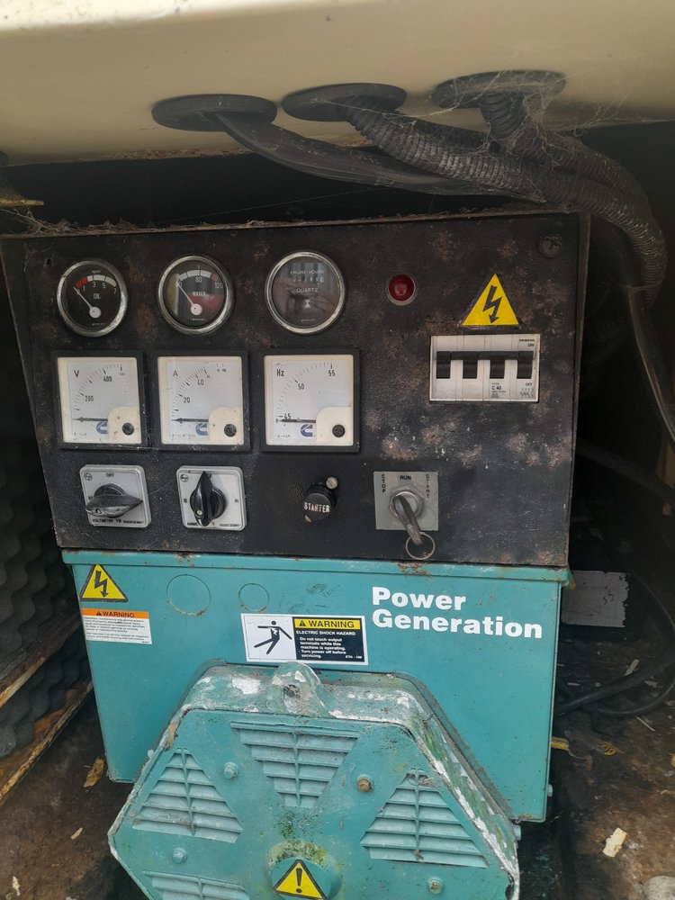

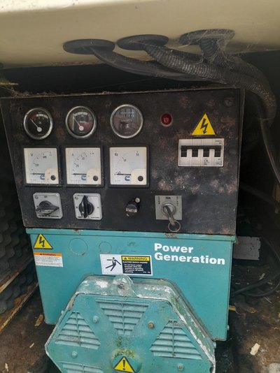

If a generator was built to be hard-wired (I.e. no socket array) then chances are it'll have a single 3 or 4-pole main output breaker only, with no RCD earth leakage trip. Here the responsibility for correct Protection & Distribution is down to the Installer (as per Mains).Because of the danger of phase to phase voltage.
