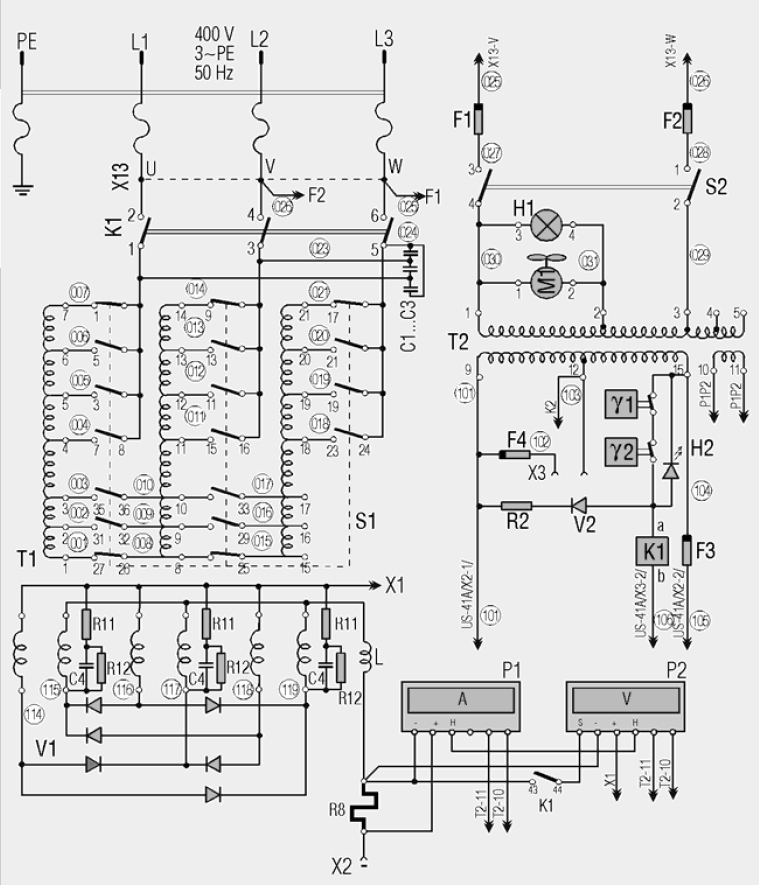

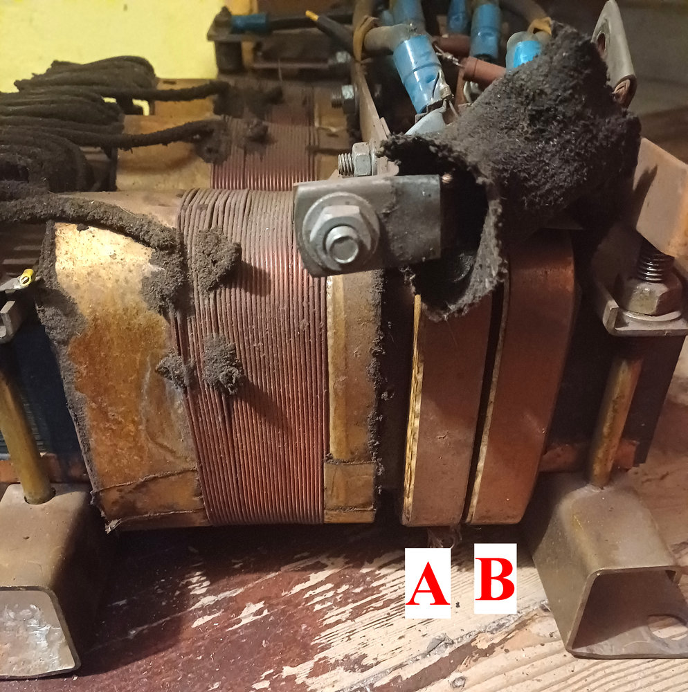

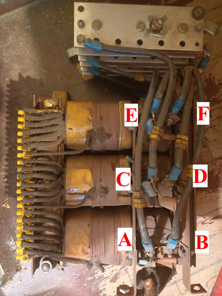

I have a old Bester Magster 160 MIG machine, in which I will replace the main transformer.

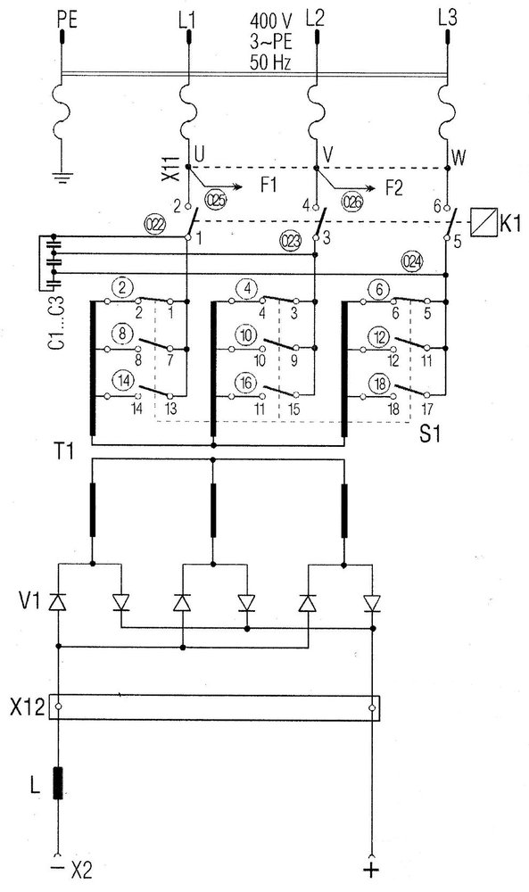

The problem is that the new transformer (photo on the right) has the simplest winding system, it has a secondary winding connected in a star (so 3 windings), while the original transformer had 6 secondary windings ((photo on the left) , connected to a specific diode bridge.
The question is: is it possible to use (maybe with some modification of the connections inside the bridge) this specific diode bridge for the new transformer?

BTW I think it's a 12-pulse bridge, but the diagram is not very intuitively drawn, and such circuits are not often encountered...
