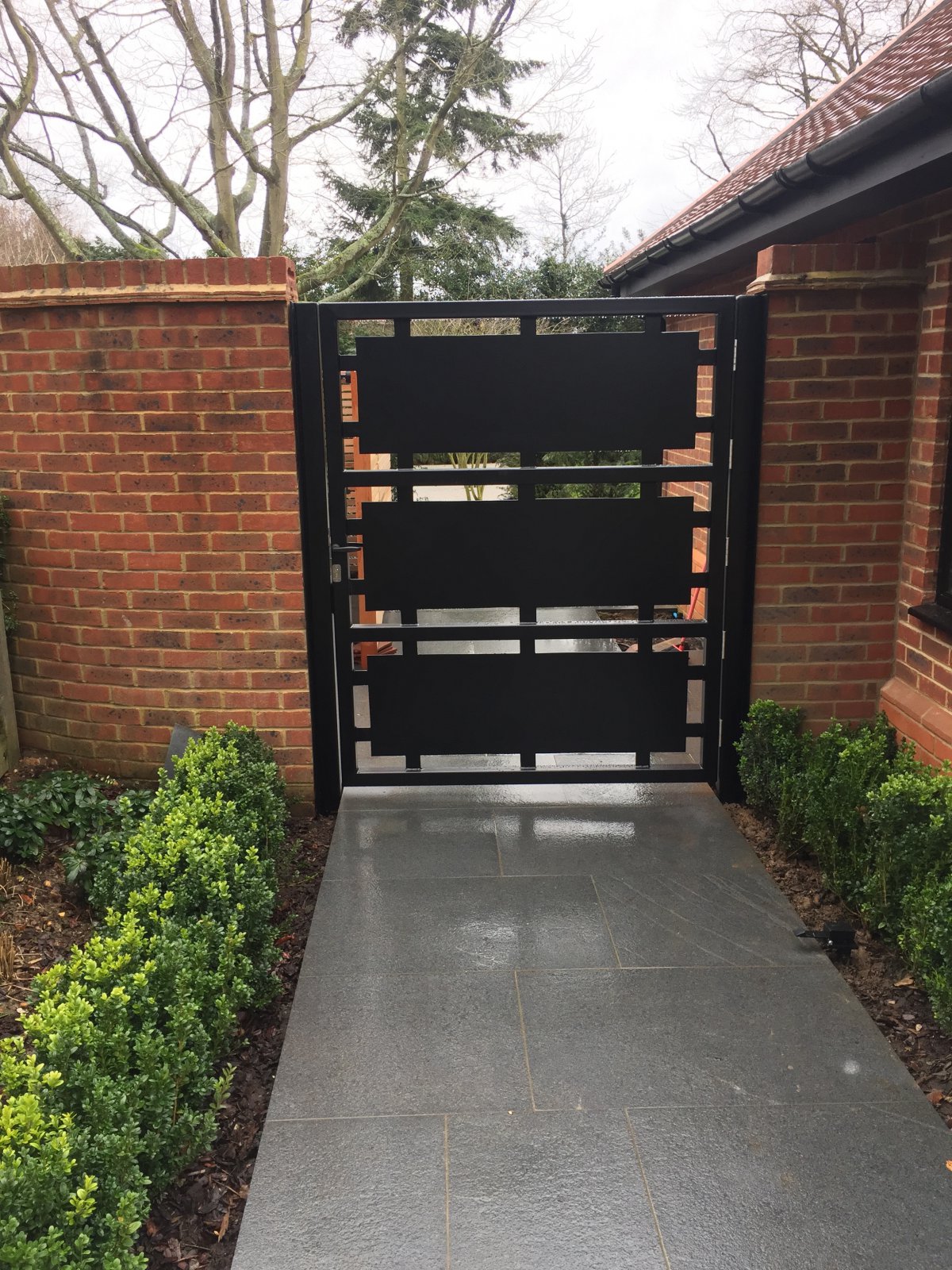

Fitted this recently at a Private clients house.
1.5m wide, 2m tall
- 100mm square posts either side with a 200x6m back plate (covering brick work)
- Gate made from 60mm square tube
- Plates are 5mm thick
- 5 x stainless hinges
- Powder coated black semi-gloss
Feedback welcome
