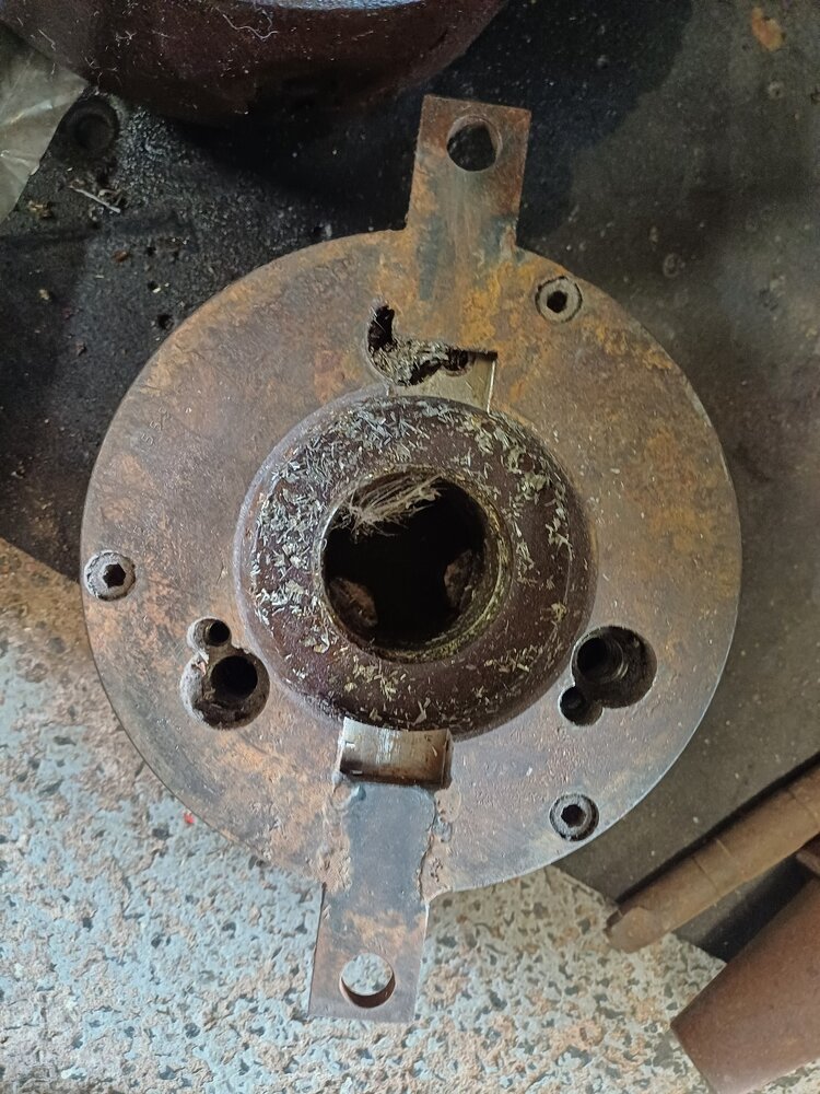

Olderisbetter Member Messages 4,035 Location Wolverhampton Monday at 9:15 PM #1 Someone adapted this chuck before it cam my way, what could the use be for? 1000017016.jpg 181.7 KB · Views: 226
Pete. Forum Supporter Messages 15,104 Location Kent, UK Monday at 9:20 PM #2 Looks like they put some tabs on it for holding down to a table. Bit of a crappy way to do it but it probably worked somewhat.
roofman Purveyor of fine English buckets and mops Messages 13,316 Location North West with water on 3 sides Yesterday at 6:55 AM #3 Or a way of holding down on a T table. dont know if Pete meant a T table or bench.
A Agroshield Member Messages 6,449 Yesterday at 7:23 AM #4 There's a big blob of weld on the drill chuck also. FWIW, it looks like a camlock (D1-x) backplate.
S Scott M Member Messages 88 Location US Yesterday at 1:14 PM #5 Of course it is possible that some daredevil without a chuck for his lathe did that so it could be bolted to a faceplate.
