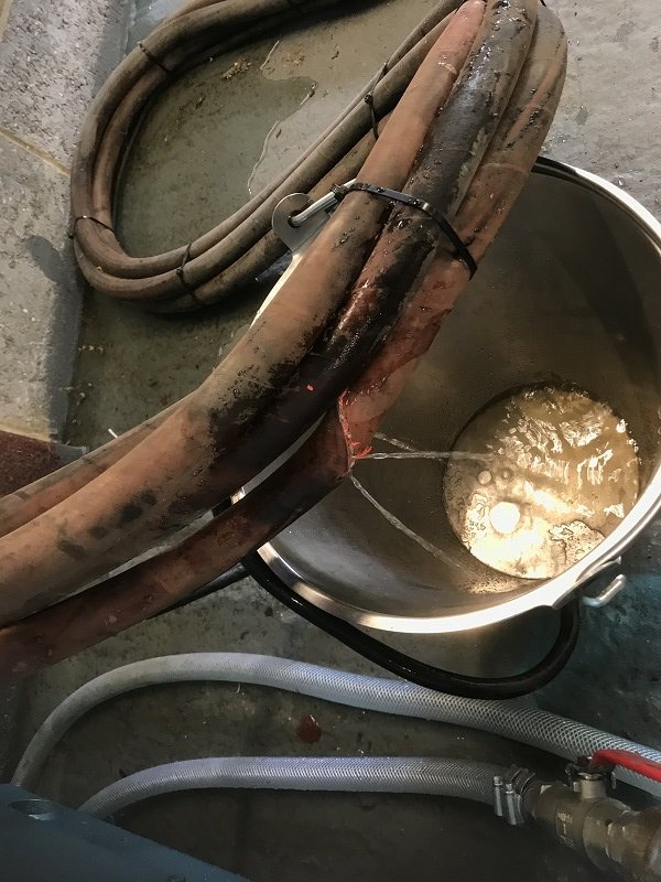

I'm in desperate need of some 3/4" 'Brewers Hose'. Used to deliver ales etc, but my Induction Furnace uses it to encase the 70 mm CSA copper cables to drive the actual furnace, and pumps chilled water down them to stop the cables melting (lots of amps here !!!!)

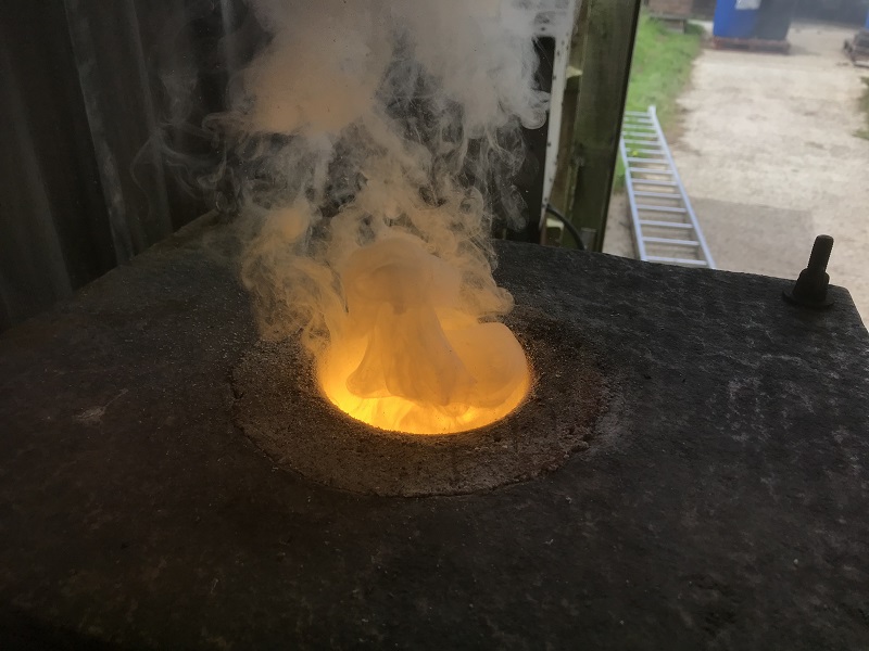

I finally managed to get my furnace working this afternoon after 13 years in storage, and had just finished the first melt when a hose burst. Now I had rather expected to have to change them, but this stuff is rather pricey so I been trying to avoid the expense.
So, does anyone have a line on this stuff at a sensible price ? I'm being quoted upwards of £16 per metre and I need about 25 metres
