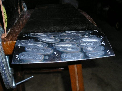

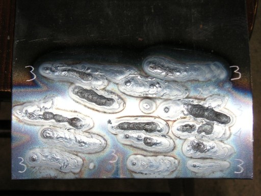

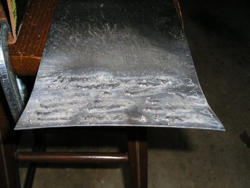

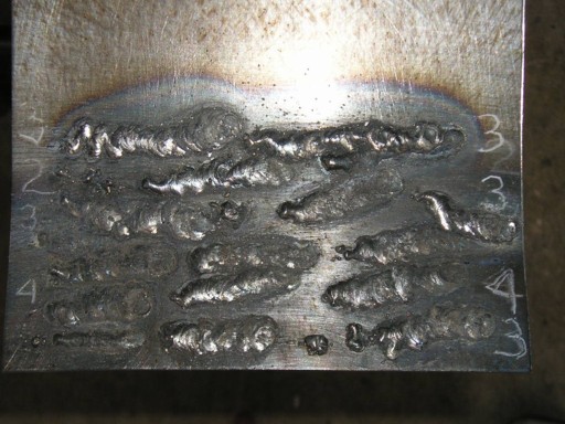

Well, I went through the entire tutorial (many thanks to all of you who put effort into creating it. It was extremely helpful!) and had my second welding practice today. I had been at Home Depot and was surprised to find some sheet metal, so I bought a piece of 16 gauge (.056 inches thick, according to my caliper), set that up and tried different welding settings.
The welder I'm using (a Dayton 6Z935C, which is definitely a hobby-type welder) has a maximum current of 85 amps, and a minimum of 30 amps. So I interpolated the four settings to 30, 48, 66 and 85 amps for power settings 1 through 4. Thanks to the tutorial, I now really understood what was meant by penetration, so I kept checking the back of the sheet to see how the penetration was going.
I also found that I was making the two beginner mistakes talked about in the tutorial; moving away from the work, so the gap to the torch is too large, and welding too fast. Once I realized this and adjusted, I was able to get very good penetration on a power setting of 3. I was able to get adequate penetration on 2 if I worked very slowly, and I got too much penetration on 4.
By the way, I was surprised that the best wire feed settings for the various power settings were almost the same. This is a very unsophisticated welder and certainly has no automatic wire feed compensation.
The splatter I had with my first welding experience was 90% gone; I assume some splatter is normal. The original splatter must have had something to do with contaminants in the scrap I was welding.
The four pictures show the welds from above and below both straight on and at a low angle, to give some indication of weld height. The numbers represent the power settings. I'd appreciate any comments on the welds and how I can improve.
One concern I had was that even the welds that otherwise looked good seemed rather flat to me. Is this normal when I'm welding thinner stock?
I find that making beads on a sheet is a lot easier than trying to make straight beads! I used a soapstone to draw a straight line as a reference, but I couldn't really see it as I was welding. If fact, I welded over one of my power setting 2 beads because I couldn't really see it, either. I have my helmet set on a shade value of 10. How do you make sure your beads are straight?
