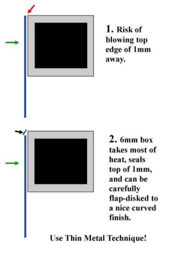

Hi Guys,
New to this place so a warm hello to all of you.
Own a Defender and bought a replacement crossmember to get through MOT.
Problem is I did not think about how I was going to weld a 2mm chassis onto a 6mm crossmember at right angles - I'm also told that my clarke 90 won't do it but some say it will if I get a good weld pool and lap it on the 2mm.
All advise and techniques would be gratefully appreciated .
Many Thanks
James
