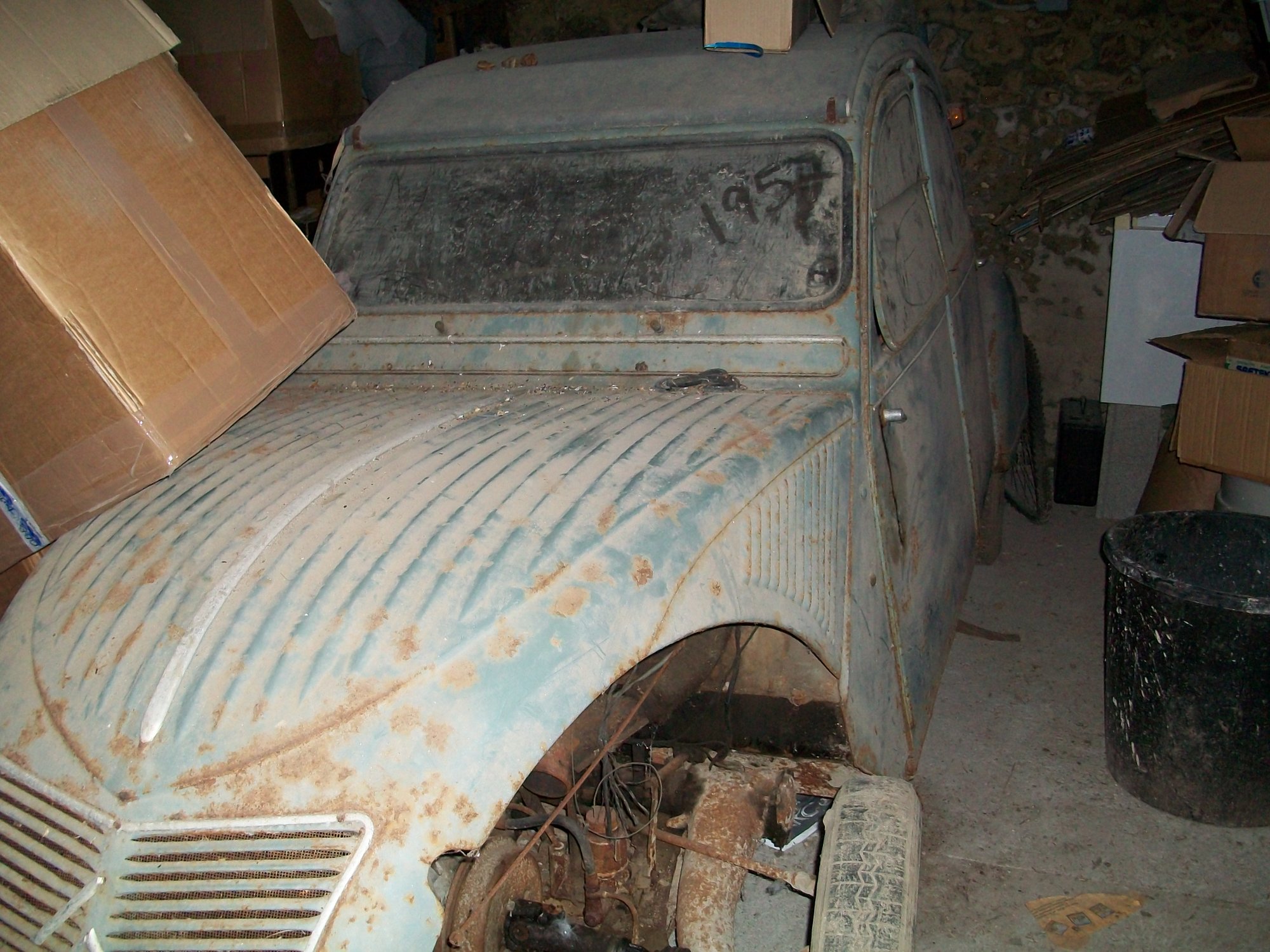

Like all good projects, this started with me being peer pressured into buying a car 125 miles away, on ebay that I hadn't viewed. The car has no MOT, and hasn't had one for 10 years. It has no roof, rotten floors, arches, boot, bonnet.... In fact I think every panel has a bit of rust. It was winched off the trailer and pushed in the garage so I am not sure if it even runs. It was raining this evening when being delivered and it was late so all I have done is receive it and push it into the garage. I will push it out tomorrow if the weather allows and start stripping it down. I will let the pictures do the talking.

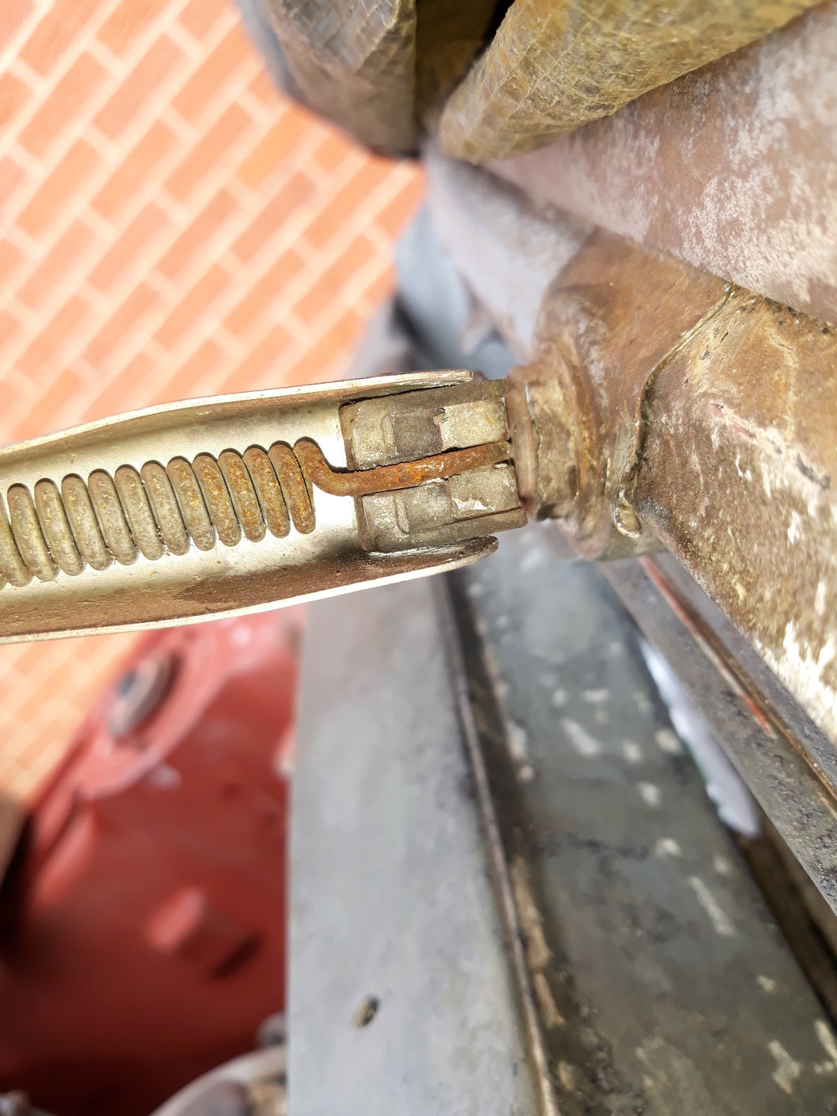

The simplicity of 2CV's amaze me every time I work on the car. After removing the front doors I was expecting the rears to be attached in a similar way, but nope, they get lifted out as you can see in the bellow image, a bit of WD40 and it slid out with ease.

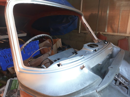

Next step is to remove the other parts on the dash as well as the rear wheel arches (lots of rust) and then asses the work needed for the shell.
