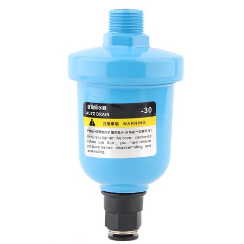

Fatherly advice on the label.I bought the a generic 240V solenoid/timer one from ebay - for my airtank drain..
But I have fitted these on the bottom of DropOut fitlers - "float drainers" - they dirt cheap and they work OK (don't leak)

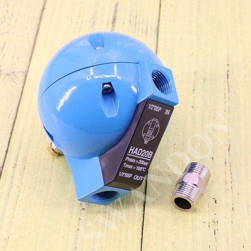

Drainage Valve Auto Drain Valve Rustproof Automatic Drain Valve Stable Durable 7361411514962 | eBay
Find many great new & used options and get the best deals for Drainage Valve Auto Drain Valve Rustproof Automatic Drain Valve Stable Durable at the best online prices at eBay! Free delivery for many products.www.ebay.co.uk
Advertised on amazon. Cheap enough. Also can wire them after pressure set so will run for desired time period every time the motor cuts in rather than on a timer. This works well if don't want it going off every 45mins.
