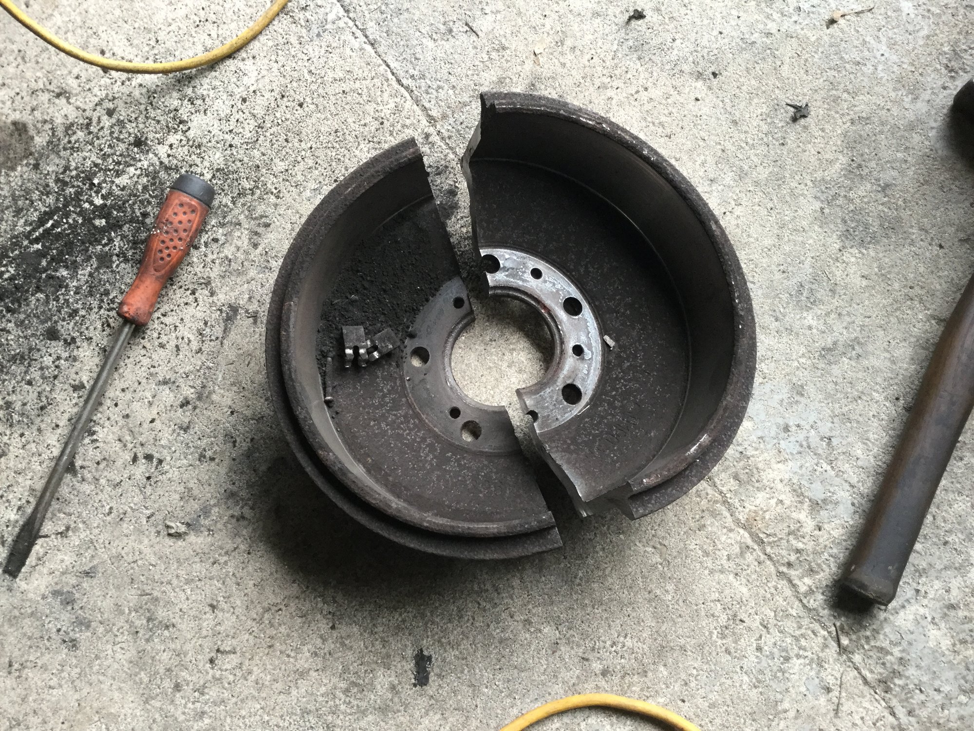

and the rotors needed a lot of attention from sitting so long!....

Each rotor was removed and gone over with a sanding disc, then the centers were cleaned up and painted satin silver....
