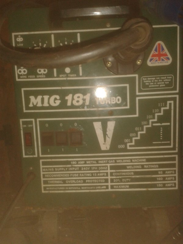

So today we had this old beast come in -
According to the owner it'd been tripping 13A fuses, didn't know what was up with it. He also wanted some general maintenance done on the machine but if it was past fixing it he wanted to have an Oxford MIG Maker 200-1 off us.

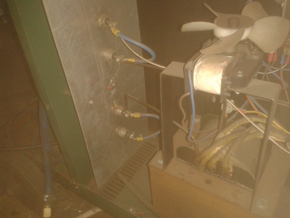

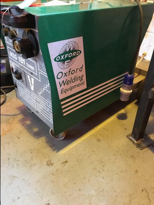

I took it into the bays to take a look at it. First thing I thought was that a 20 year old 180A transformer machine should not be running off a 13A plug at top end (which is what he'd tried doing). I tried a new 13A plug and plugged it into the socket, no joy, no lights.
I lopped the plug off & fitted a 16A blue plug just to see if it would fire up, if not it'd be a side panels off job.
Popped it into the socket and it lit up
, lovely. Now to make sure that the machine can still weld etc..

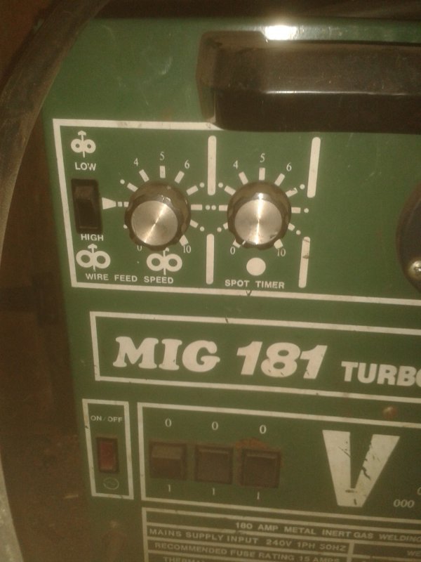

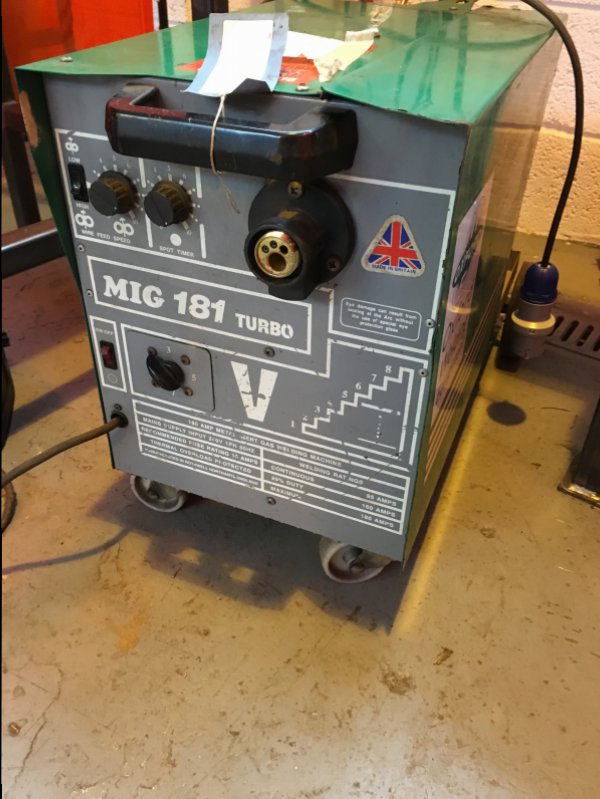

Popped in some 0.8MM wire and connected up the torch & gas, played with the settings and away we went.
Welding like a brand new machine, very nice welder.. never used one this old before; it's actually older than I am
I took a look at the earth and decided it needed a new one as a result of the arc strikes on it, fitted that.
Gas hose fittings were looking past it, fitted a new 3/8 nipple & nut.
Guy decided he wanted a new torch, new Binzel MB15 ready for him to pick up next week with his machine.
It had a general clean up too.
I chatted with the guy and he said that he didn't have 16A sockets in his workshop but it was going to be cheaper to get it fitted into his shop & pay for the fixings & maintenance than it was for him to buy himself a new welder. Now he's a happy chappy.
He's now got a genset that he's bringing in for us next week to take a look at, I think that might be past me so that'll be passed onto Mark or Jonathan.
Thought that it might be of interest to anyone that wanted to see an Oxford from the era before Technical Arc took on the Oxford name & started making them up in York. A relic to admire imo.
*EDIT* I removed the 16A plug once I had tested it, as I'm not allowed to give it back to him when its been wired up by myself. Customer has had the plug off us & he's fitting it himself.
