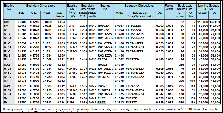

I would like to change the bearings in my die grinder
There are four bearings in total
One set is a WIB R6ZZ
Other set is Germany GMN 607
The unit spins at 18,000 rpm
Obviously the bearings need to be quality and long lasting
Any idea where to find these or a quality replacement brand
