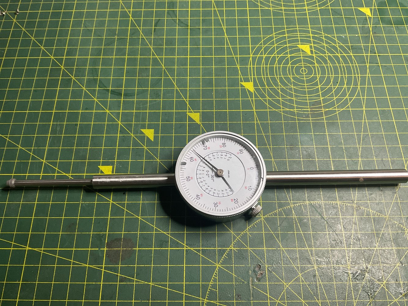

This type, from ARC:

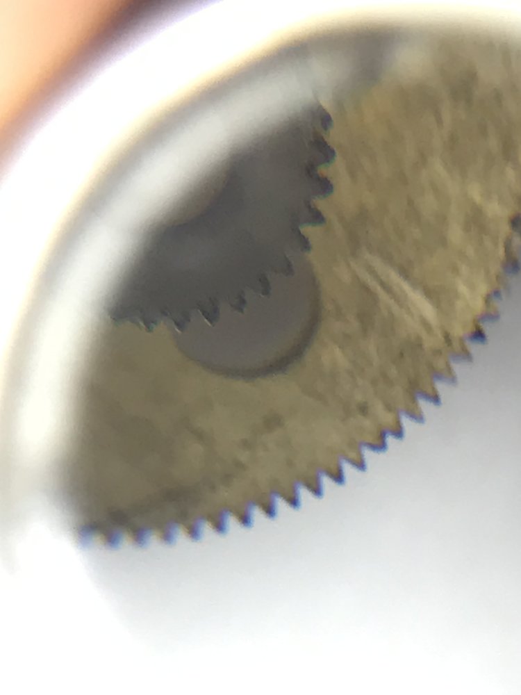

Sticking repeatably at two or three points.

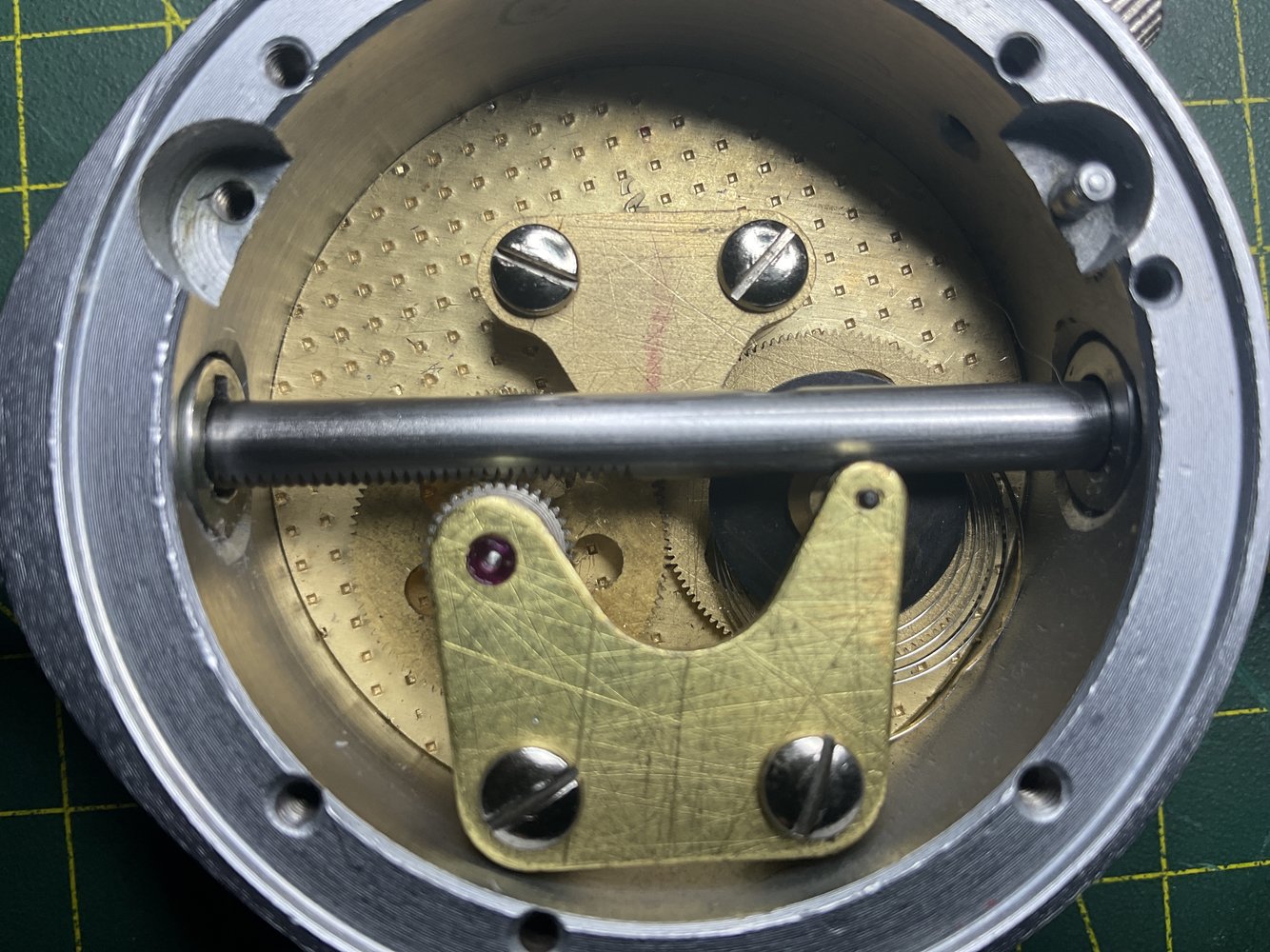

The rack and pinion part seems to have too much lash, so the teeth are trying to overtake each other at times. There doesn’t seem to be a way of adjusting it. The brass plate has no play for adjustment that I can find:
Return, or am I missing something?
