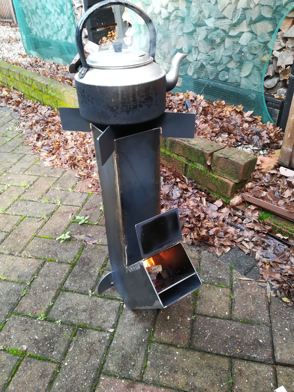

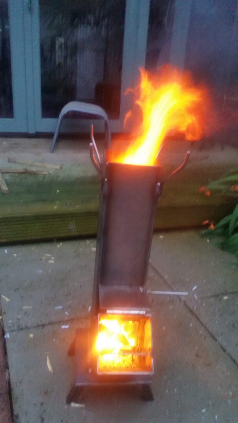

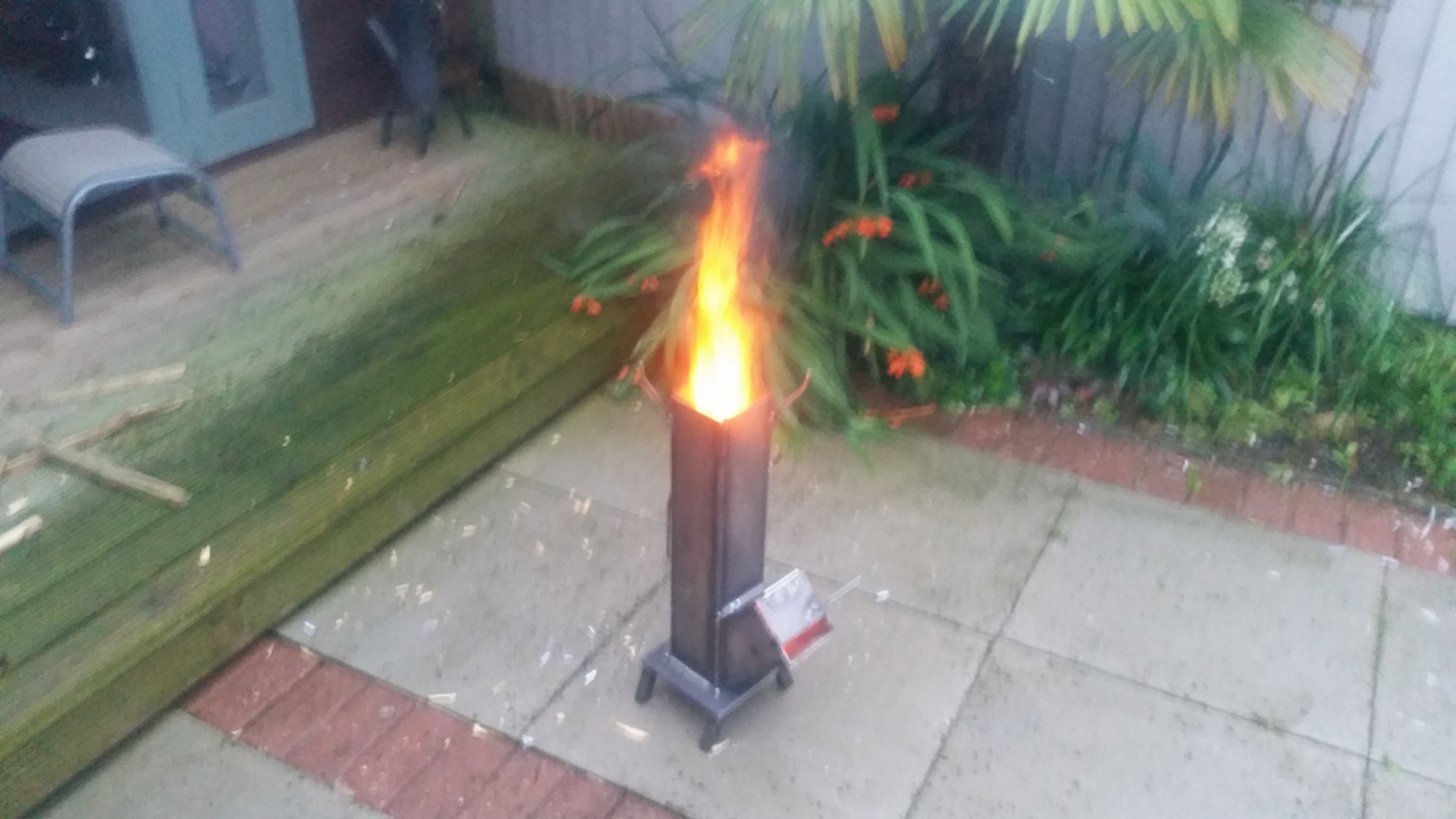

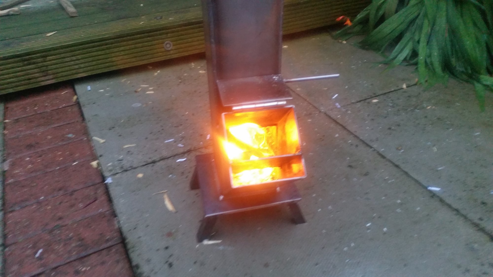

Yes i was frying bacon in the garden at about 10deg CTasted good though.

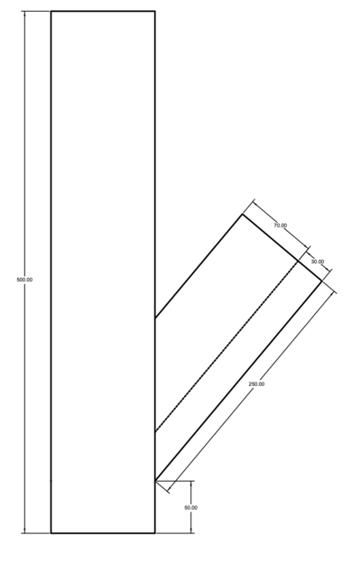

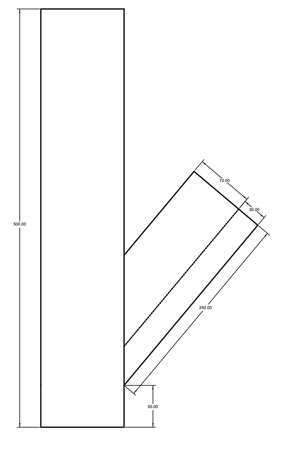

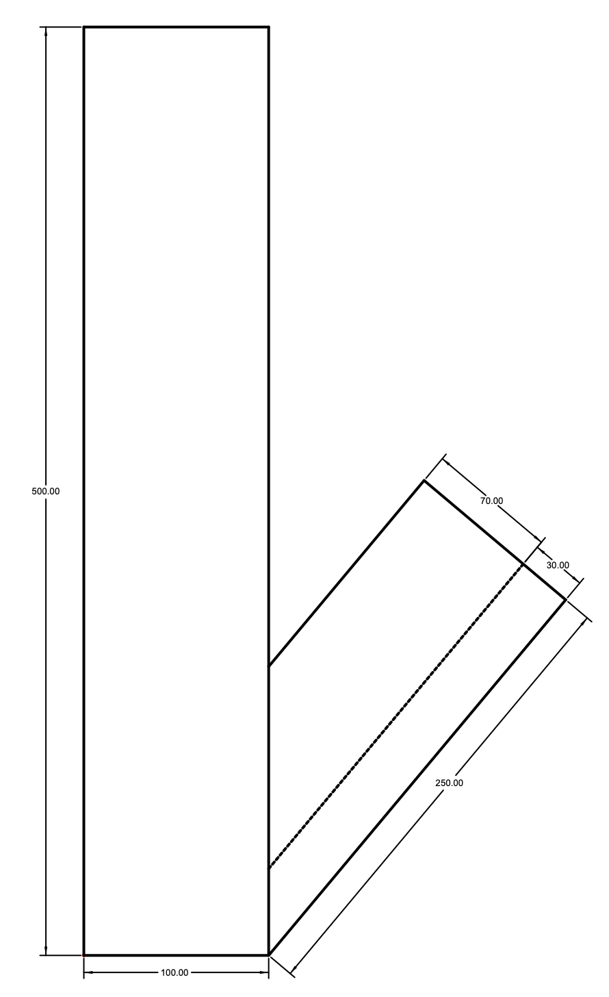

The feed hopper angle is 50 degrees, I read that 50-60 degrees worked well so chose 50.

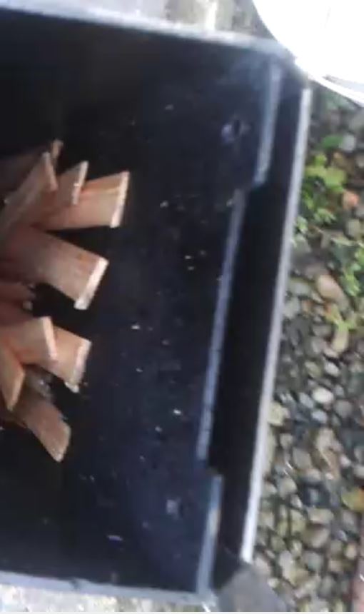

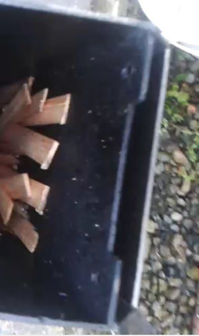

the original design is apostals heres a bigger version take note of the wood used
