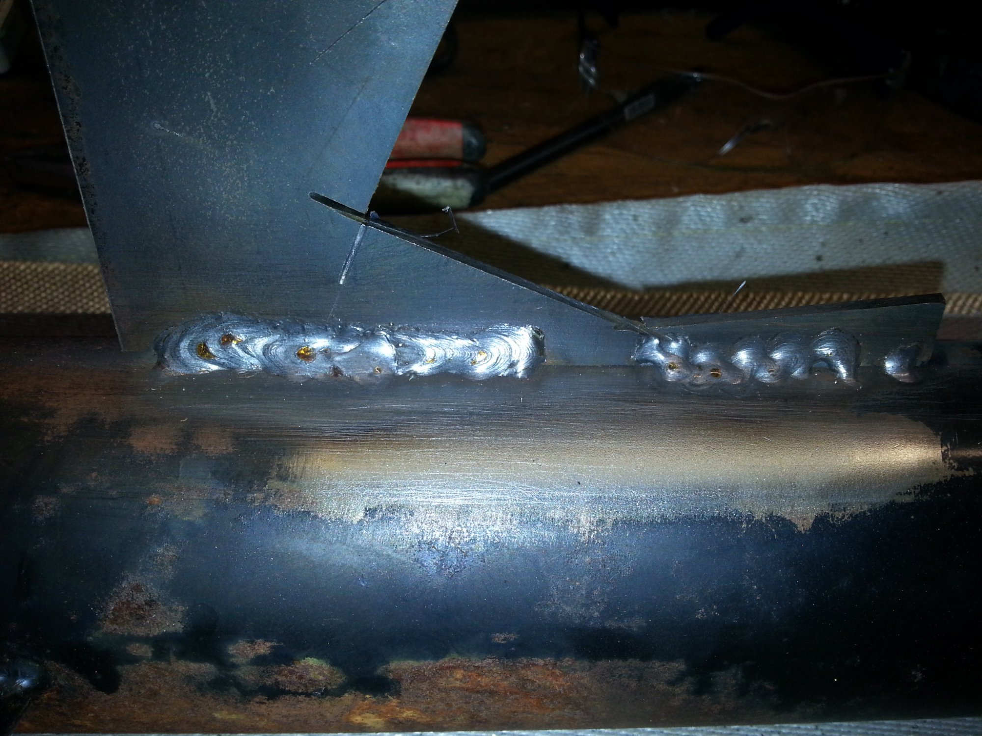

Made an exhaust flange to mount a pipe to a silencer. The 1mm pipe passes through the 3mm flange, sticks out 5mm or so and is welded there. I have never welded anything less than 3mm so spent some time getting the machine (CWS 160i) set up, ended up running 70-75A wire speed of 3 (don't have the manual handy for the conversion).
I think this looks OK ?
The 2 problems I encountered on the job are that
1) with the lower power I don't seem to be able to see anything even with the helmet turned right down - I do have an overhead light so maybe it's that?

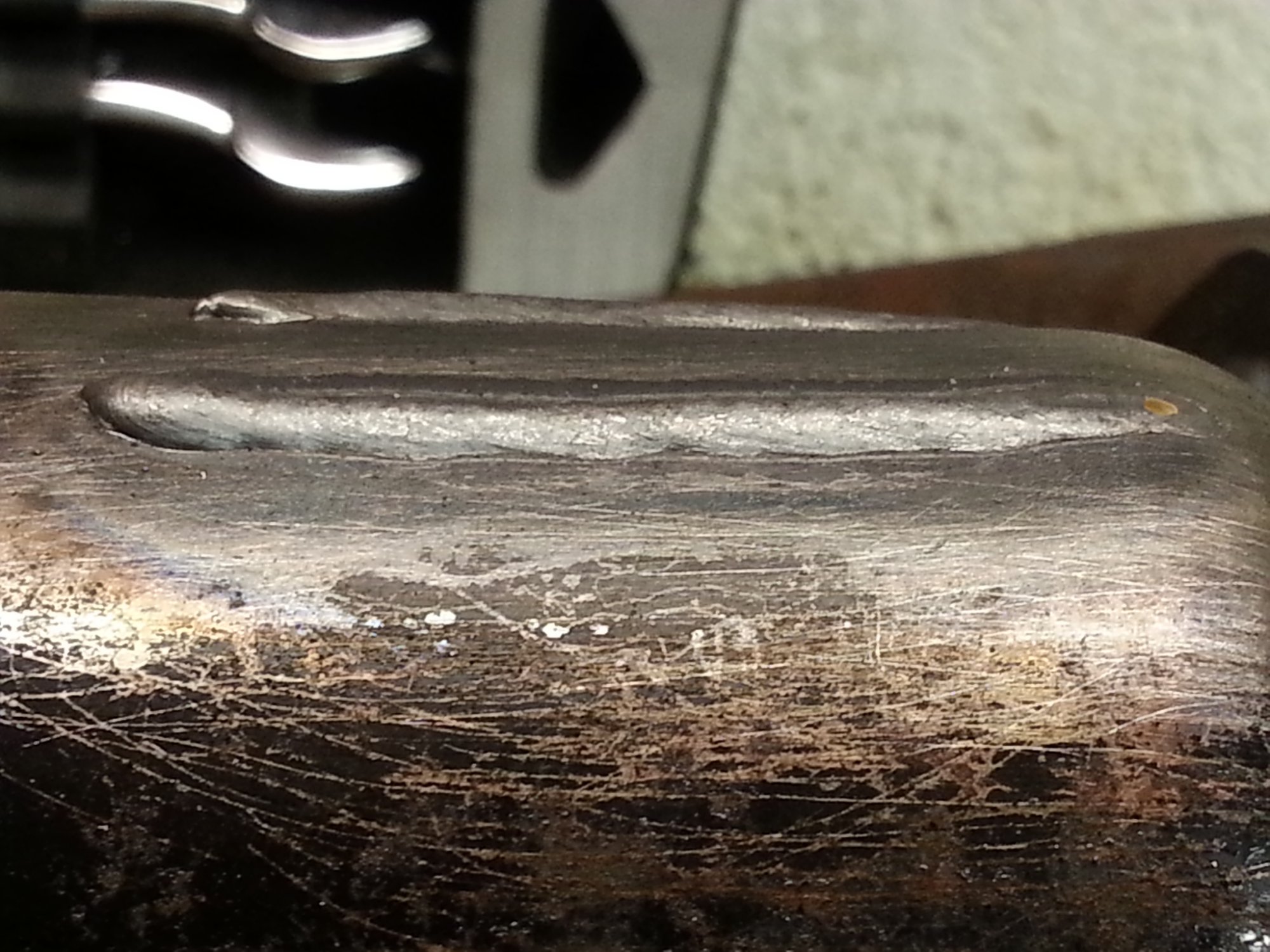

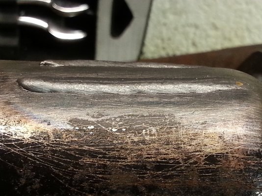

2) Possibly because of 1) but I don't think so, the weld seems to end up on one surface or the other but not in the joint as a nice fillet. Didn't have this problem welding the thicker stuff for the previous jobs. Will get a pic of the problem tomorrow
Suggestions please!
