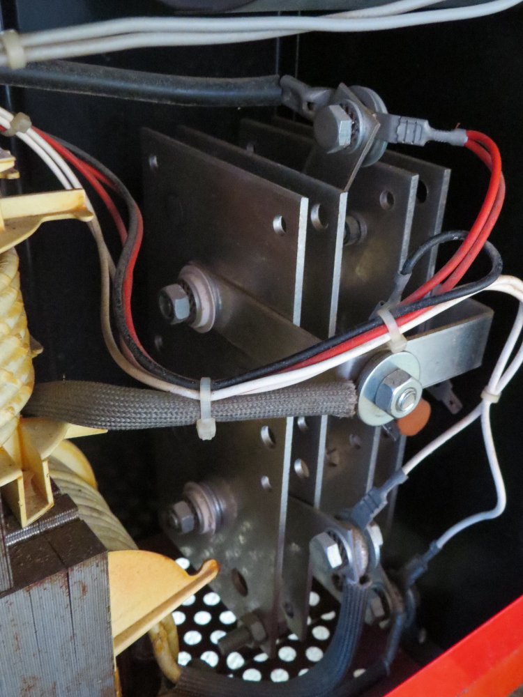

Hello, I have finally bitten the bullet and got around to doing this job after around 36 years of owning this welder:-)

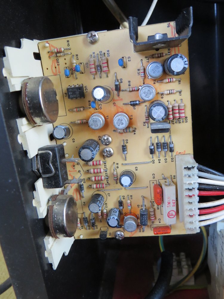

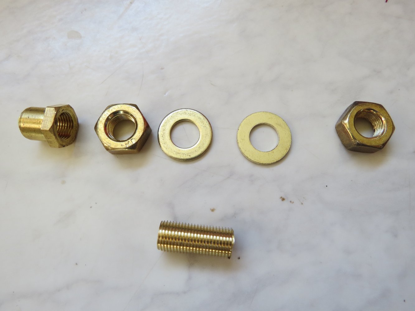

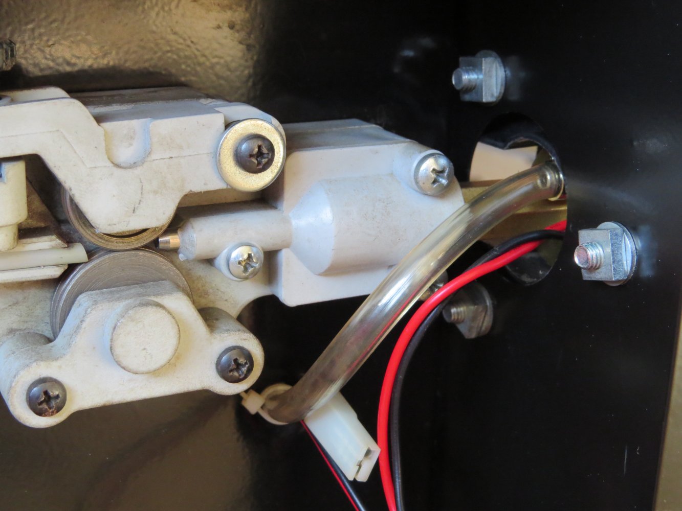

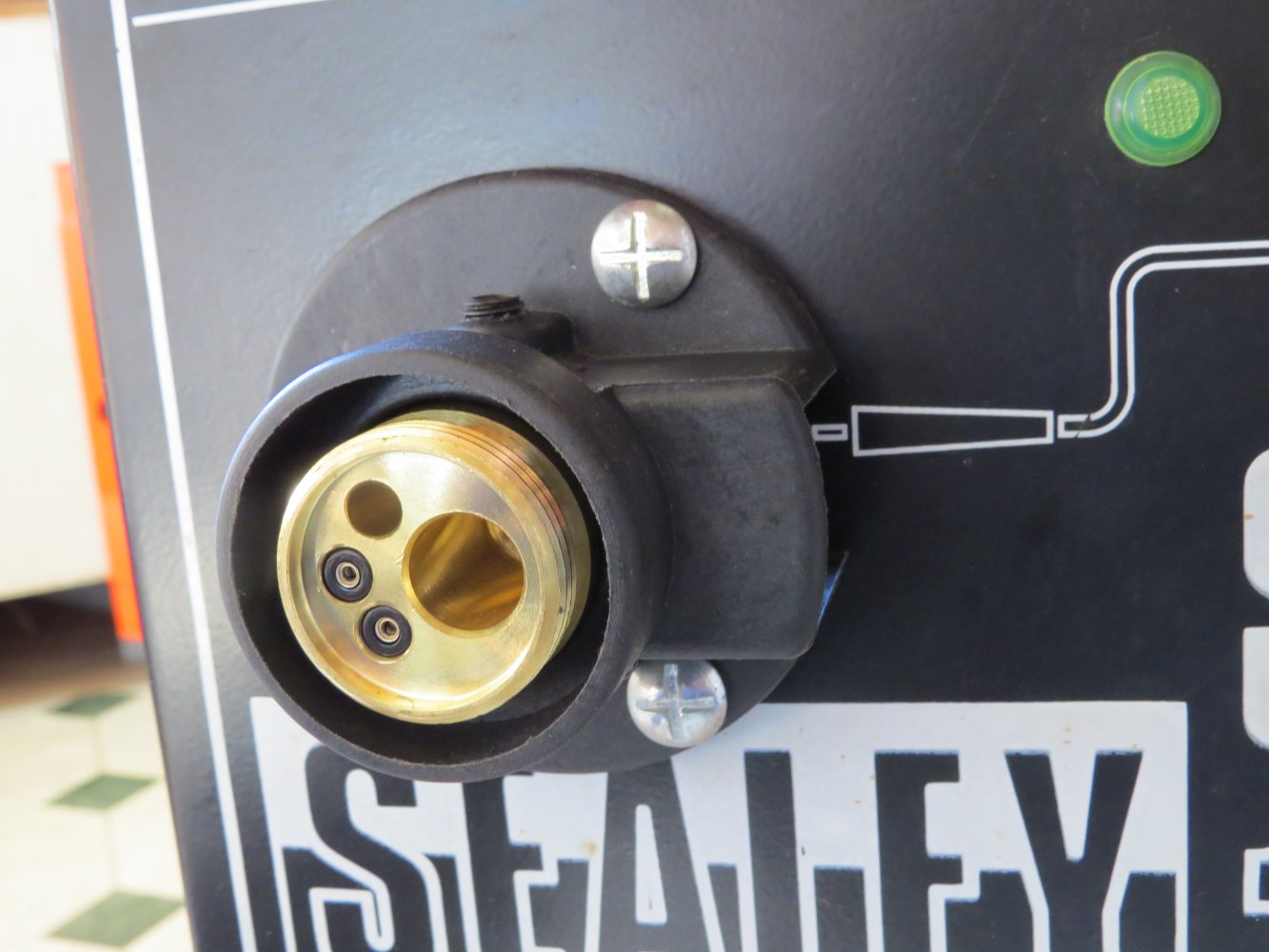

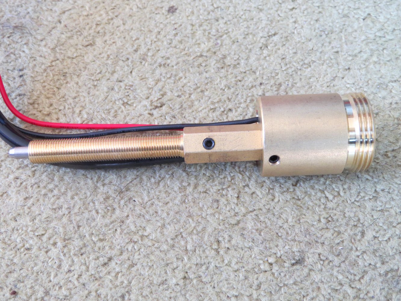

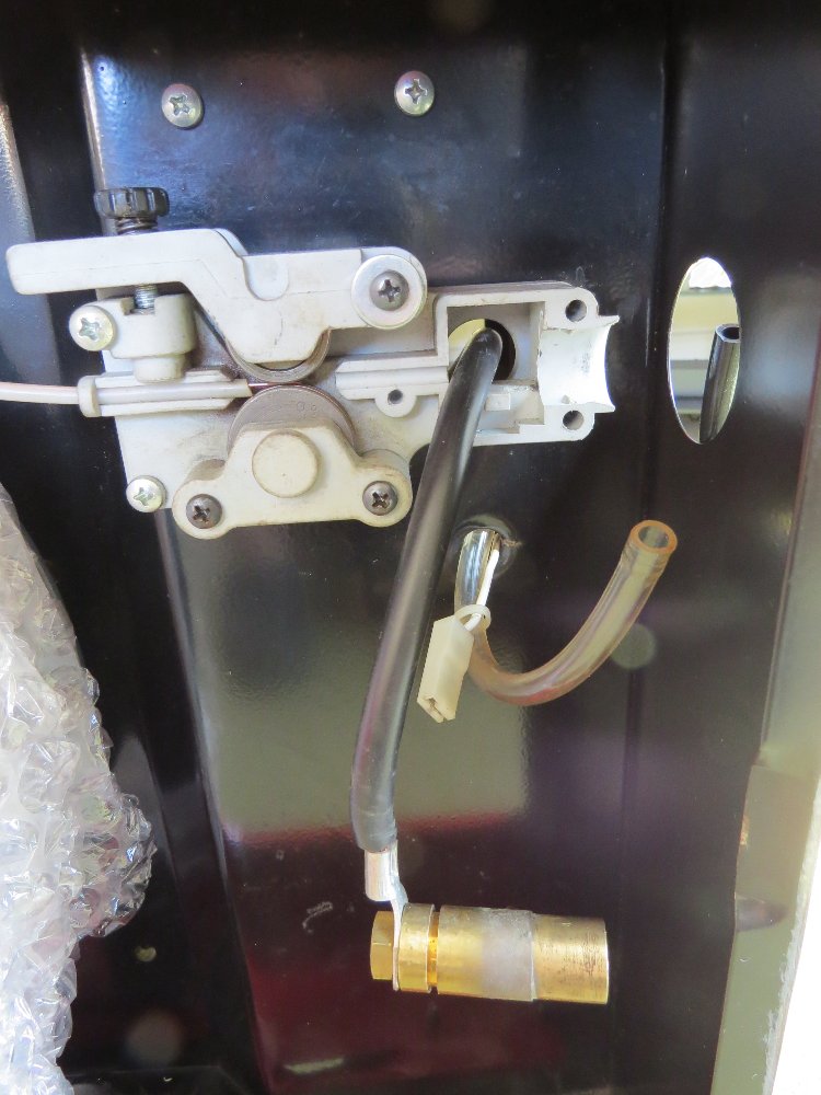

I have fitted the Euro adapter, having removed all the included nuts and washers, cut off an inch or so of the brass threaded bar and drilled out the liner holder from 4mm to 5mm for the wider euro metal liner. As you see in the bottom of the first pic, there is a brass piece hanging down, that was threaded on to the old torch, with a heavy duty earth type lead connected that runs to the rectifier under the fan, see the second pic.
Am I right in thinking that this needs to be completely removed?
The original torch had one wire connection, white wire with connector in first photo and I think this needs to be connected to either one of the red or black wires on the Euro adapter?
Where do I connect the other wire please? I am thinking it may go to the same place as where the big old wire mentioned above is connected but hopefully someone can confirm.
