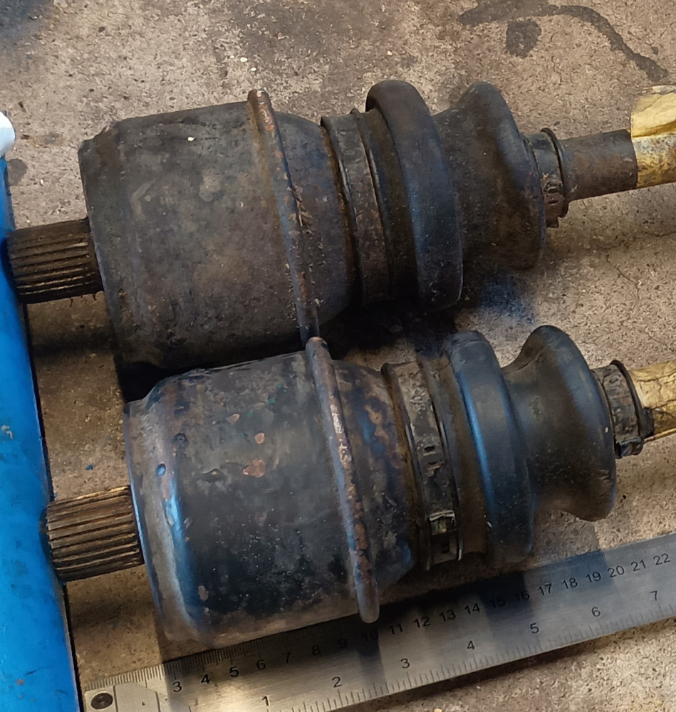

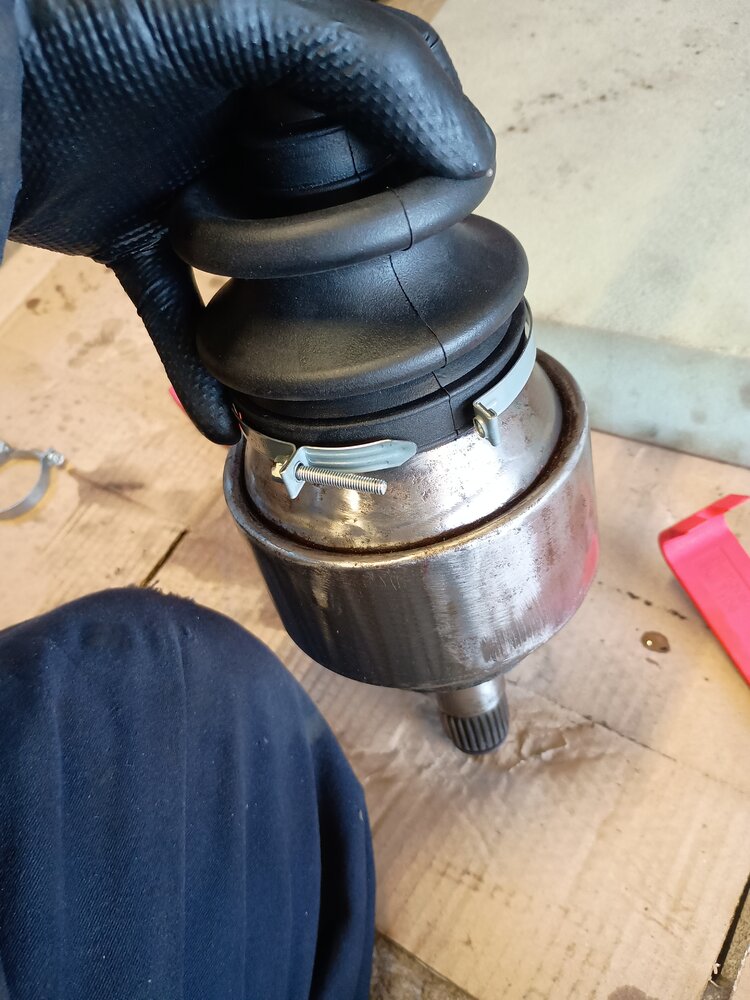

These are my 46 year old axles, boots cracked but not yet leaking.
To get new boots on it will either need stretch boots and tool or the cans to be cut off and replaced, and crimped together.
The tool used to crimp on the axle cans to allow boot renewal on our axles is NLA, and was thousands of £ when it was available. There are videos on you tube showing how to chisel the edge of the can over to crimp the o ring in place but they look hit and miss. I also plan to fill my can with oil rather than grease so it needs to be a perfect seal. I'm not sure a chisel can achieve that.

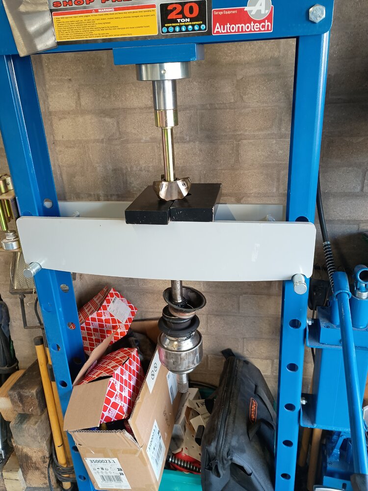

There is very little to no information on the internet about the tool so a fair bit of guess work was required to design a replacement.
These are the only pictures I had to go on.
The lower part needs to come apart once the crimp is made so it can be removed from the axle, the upper parts forms the crimp when compressed down on the two sides of the can.
I measured up my existing axle and ordered some laser cut steel. One ring for the top die and four semicircles for the lower.
I tac welded the semicircles together to hold steady for drilling.
Then the same for the top part. Then dilled it through.
The bead measures 7mm on the old axles so I recessed the lower die by 3mm and the upper by 4mm and sized the width to the new can parts.
Similar for the top tie, 3.5mm concave radius on each side.
