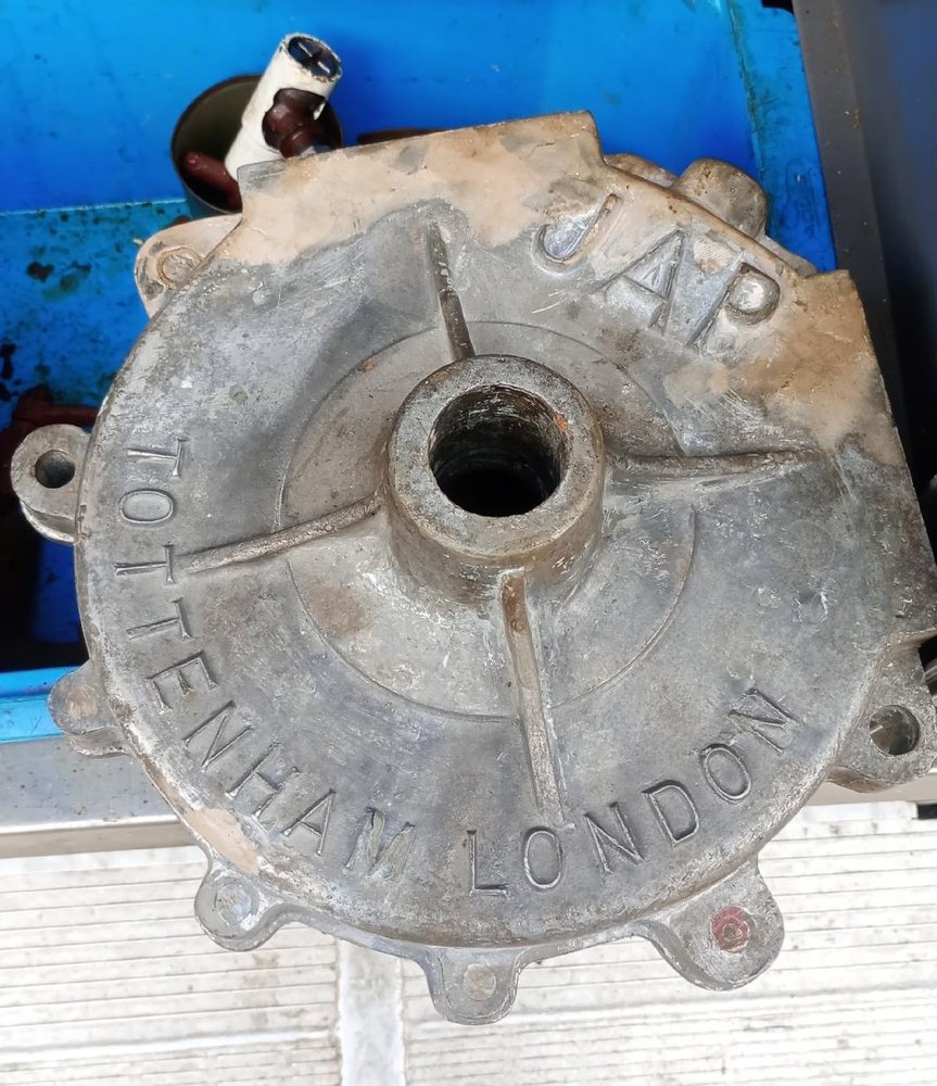

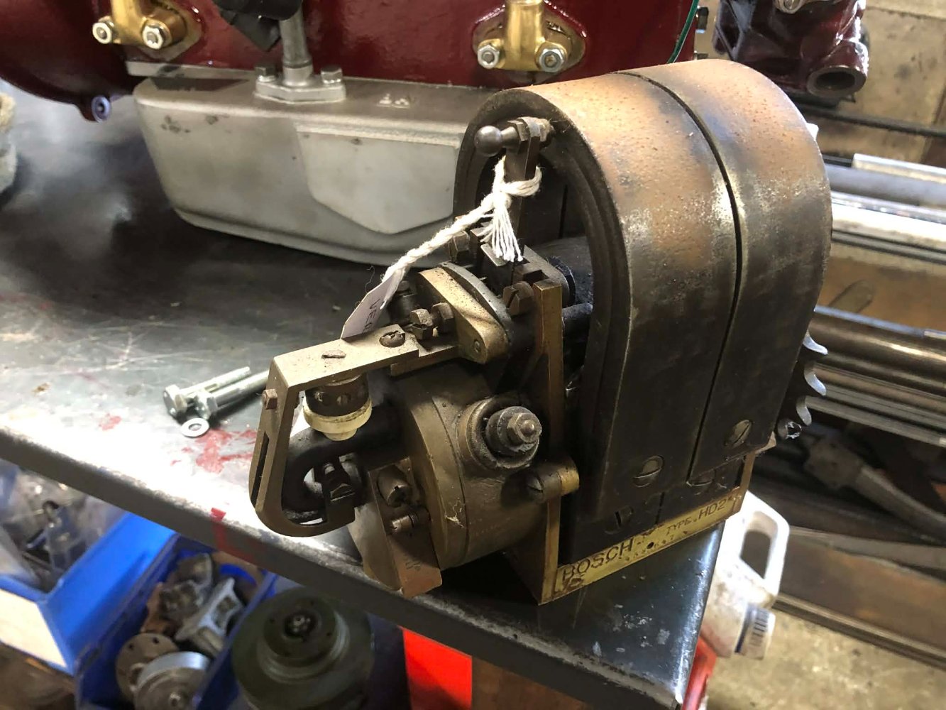

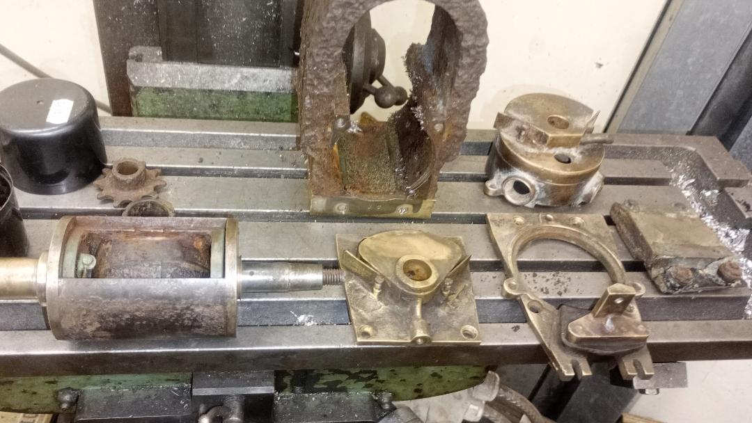

Seadog Save the planet. It's the only one with rum! Messages 12,913 Location NE London - UK Dec 23, 2025 #21 What does rotate, then? Something has to.
Matchless I started with nothing, still have most of it left Messages 2,950 Location Essex UK Dec 23, 2025 #23 Seadog said: What does rotate, then? Something has to. Click to expand... Took me a week of looking at it to work it out, these bits are from the fossilised magneto, apart from the end bits,

Seadog Save the planet. It's the only one with rum! Messages 12,913 Location NE London - UK Dec 23, 2025 #25 It's a pretty standard configuration. The rotor should rotate. @zeppelin builder builder probably has a spare under his bench
Matchless I started with nothing, still have most of it left Messages 2,950 Location Essex UK Thursday at 7:20 PM #26 Matchless said: View attachment 524254View attachment 524255 Took me a week of looking at it to work it out, these bits are from the fossilised magneto, apart from the end bits, Click to expand... The upper part in the pictures rotates around the stationary armature.
Seadog Save the planet. It's the only one with rum! Messages 12,913 Location NE London - UK Thursday at 7:58 PM #27 Ah. The slip ring fits on the rotating magnet I suppose?
Matchless I started with nothing, still have most of it left Messages 2,950 Location Essex UK Friday at 1:02 PM #28 Seadog said: Ah. The slip ring fits on the rotating magnet I suppose? Click to expand... Yes, that picture was taken for a different reason, and No because that is not a rotating magnet, it is a rotating magnetic field chopper, the magnets are horse shoe type.
Seadog Save the planet. It's the only one with rum! Messages 12,913 Location NE London - UK Friday at 1:32 PM #29 Very interesting.
