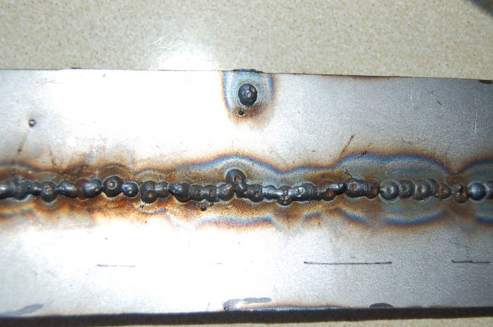

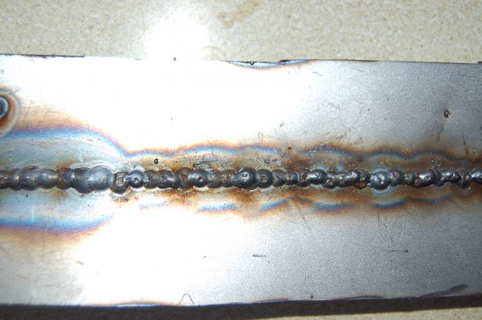

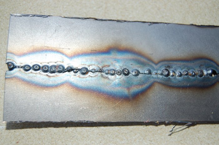

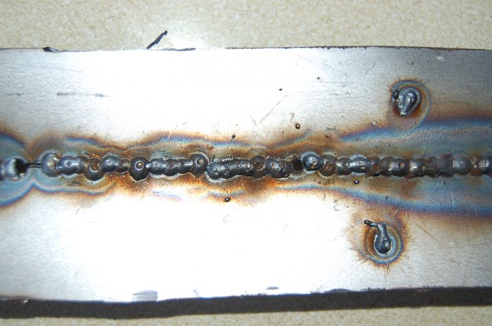

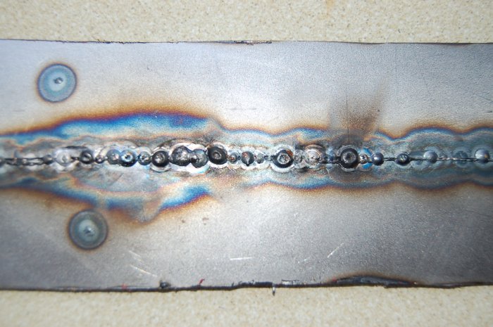

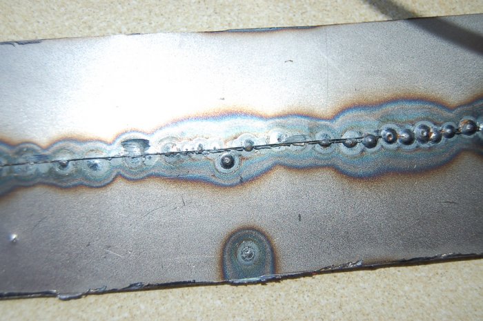

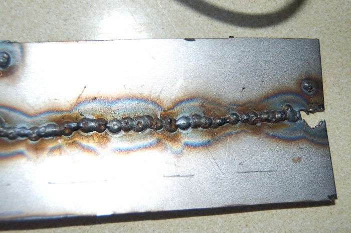

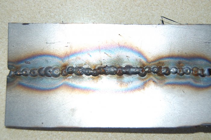

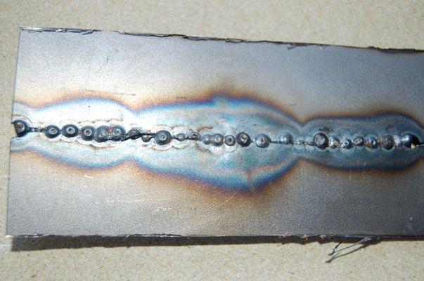

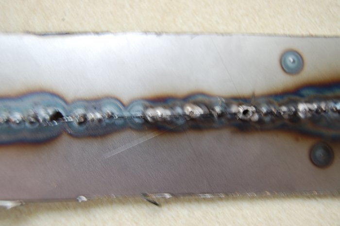

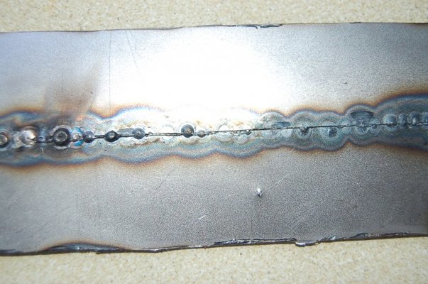

Had a go at butting two 18" strips together. Darted around a fair bit to try and keep localised heating down plus periods waiting for it to cool down. I've used the pulse method from this site to join the strips together. My first attempts lacked penetration so I upped the power a bit. Managed to blow through a couple of times - my technique the problem not too much power I think. Any comments please. Had to photograph in strips due to its dimensions. Studying the picture I think I am being erratic with gas coverage - think I may be holding the torch at too much of an angle ot too far away to enable me to see the tip. I notice that the far left welds seem good.
