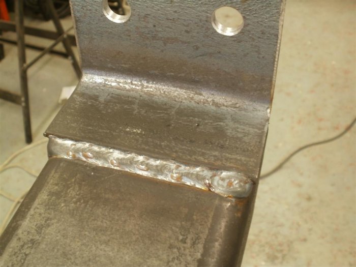

Hi Guys,
quick post to see whether the more experienced of you could cast a quick eye over these photos? I switched from welding with 0.8mm gasless wire to 0.8 normal wire with Argoshield light last night. For some reason I CANNOT get the kind of penetration that I was achiving before? I must be doing something wrong but I couldn't figure it out last night, so I figured I'd ask you guys.
I played with the wire flow speed and all other settings on the welder, but I'm not really getting any mayor penetration. The weld just seems to 'sit' on top of the material. It gets proper hot and glows red hot, but it just doesn't go into it enough. Is my welder not strong enough for 4mm steel angle? If I weld towards the edge of the material it will eventually blow a hole into it, indicating enough heat, but when I weld towards the middle of the piece it just 'sits' on top. Maybe I'm expecting too much???
Welder: 170Amps
Wire: 0.8
Gas: Argoshield Light
Metal Thickness: Mostly 4mm angle, and some 6mm plate Mild Steel
Amp Setting: Max! (6)
Regulator works fine, checked yesterday. Had the WHOLE thing apart!
Entire front part of torch has just been replaced with new parts (new shroud, nozzle, holder, spring, etc)

I was asked what kind of thickness I wanted to go up to and I said up to 6mm... and they recommended Argoshield Light. Feck. Now I'm stuck with the bottle for a while.
