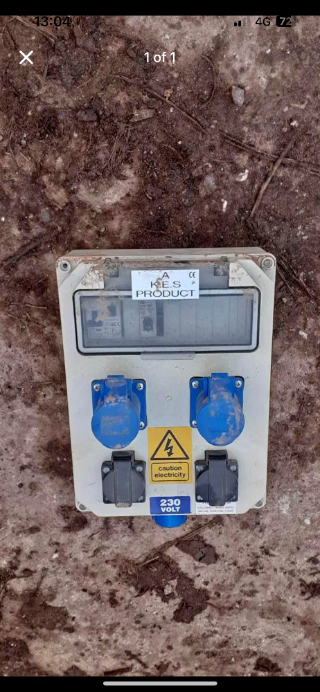

yep even a cheaper one with a double pole main switch if you feed it from an rcd dbThis one maybe

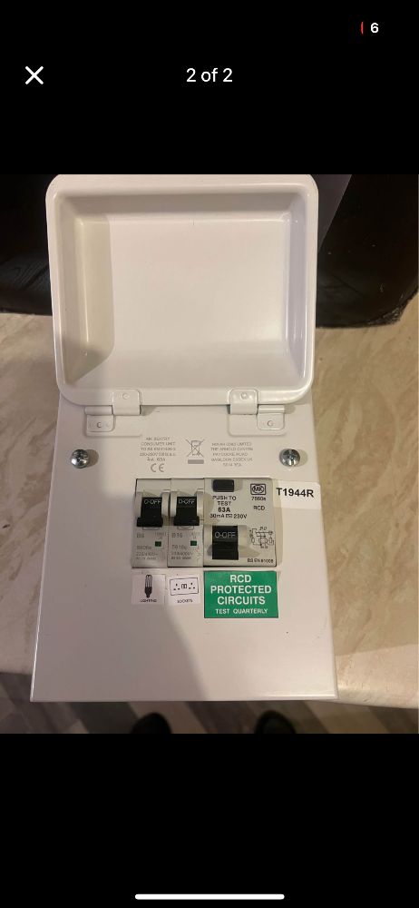

Just sockets & lightscould just upgrade compressors to larger cable and 32 amp plugs, then fit 2x32 amp sockets on the wall with a single 32 amp breaker?
personally I think I'd just do a 32amp breaker with 2x 16amp sockets, but appreciate that's "against the rules"

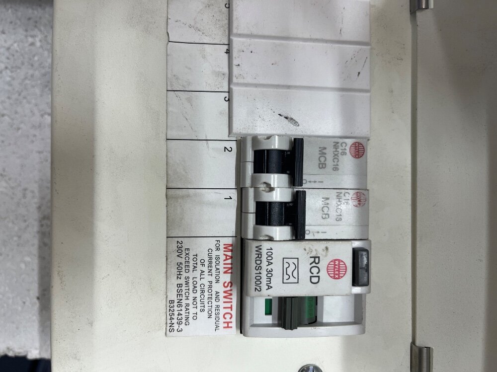

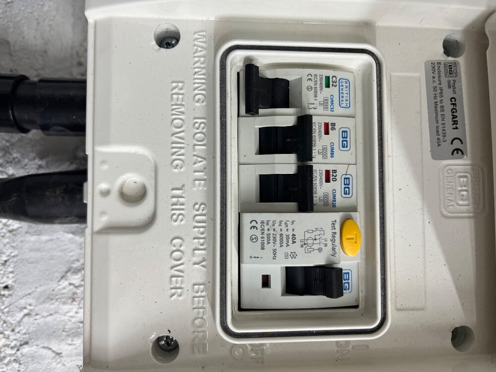

what are the other breakers in the box and what are they doing? post a photo?
If you are going to install MCBs, usually C type.Ok folks,I’m fitting another small consumer unit in the garage wired from the original one in the garage,but do I need to fit c type mcb or b type?they are b type in the first c/u,and had no problems with the compressors running.
Sure but then I wouldn't be installing MCBs or advising anyone to do so.Providing you can meet the earth fault disconnection time in the regs![]()

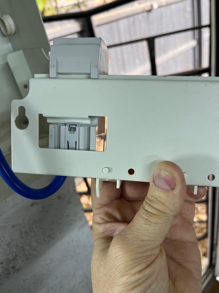

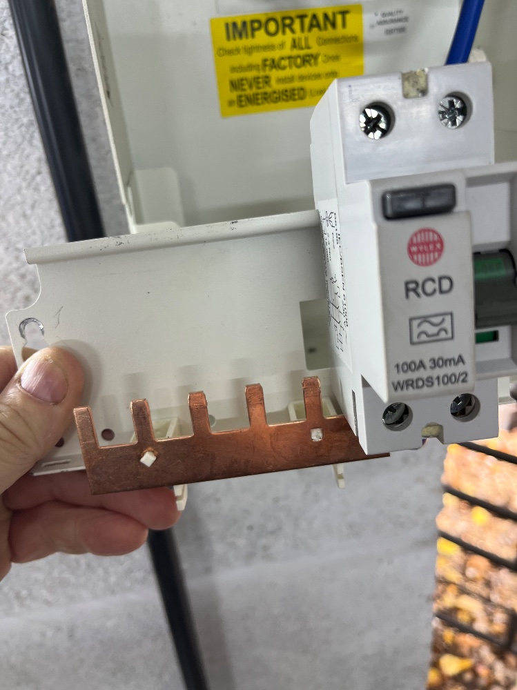

so just pull it off and slot it on to the copper dinrailThe MCB hooks onto the top and the bottom terminal tightens onto the busbar.
The clip on the bottom of the MCB is not used in this application
Oh right no probs,thanks.The MCB hooks onto the top and the bottom terminal tightens onto the busbar.
