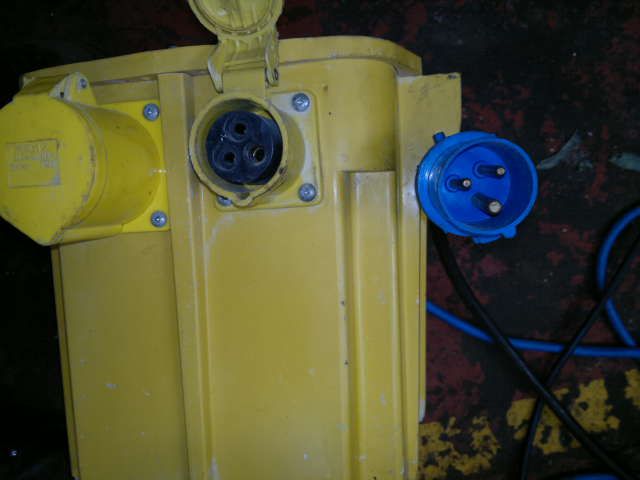

what's the input current required?
thats the voltage not the current draw its probably 16 amp if its blowing 13 amp fuses . if thats the case a dedicated supply is required not just the adaptor lead or a 110 plugAC220(single phase)
AC220(single phase) output voltage is 110 Volt
Is that the rating of the transformer, not the plasma cutter?
Oh right,I was expecting the transformer to have adequate gadgetry inside.If the 110V transformer is plugged into a 13A socket you'll still have the same problems- a 13A plug isn't man enough. That's why it came with a blue commando plug fitted.
You're correct,it doesn't help when my computer crashes,and training on a new job,my head is spinningForget it, you're not understanding those figures you posted.
A mate of mine who's an electrician put the new supply in my garage complete with a fat armoured cable ran back to the house fuse board,did you pay an electrician for that chevy2? if so what price, may help others in the future
