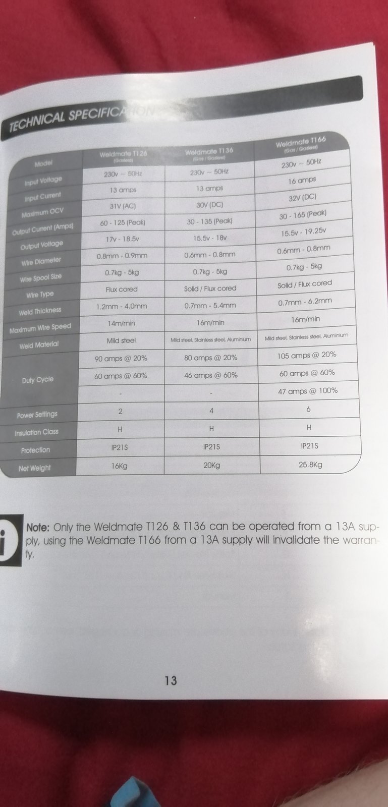

Unfortunately you need something to plug the transformer into either a generator or the grid!
Extension lead would still have a 13a plug on it though and the Volt drop wouldn't help much at that sort of length on an extension lead as they are not usually very thick some only have 1.25mm cores!
