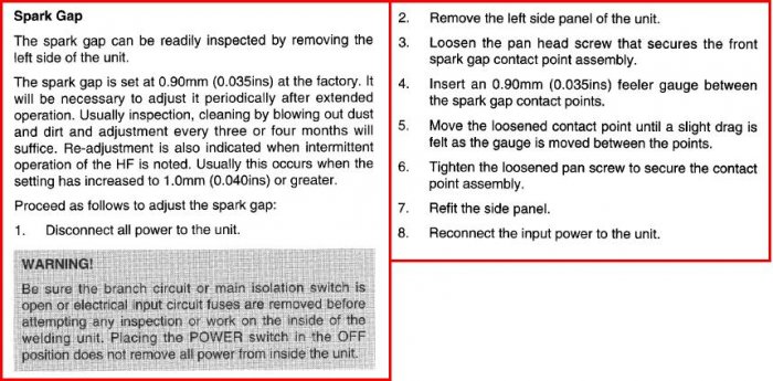

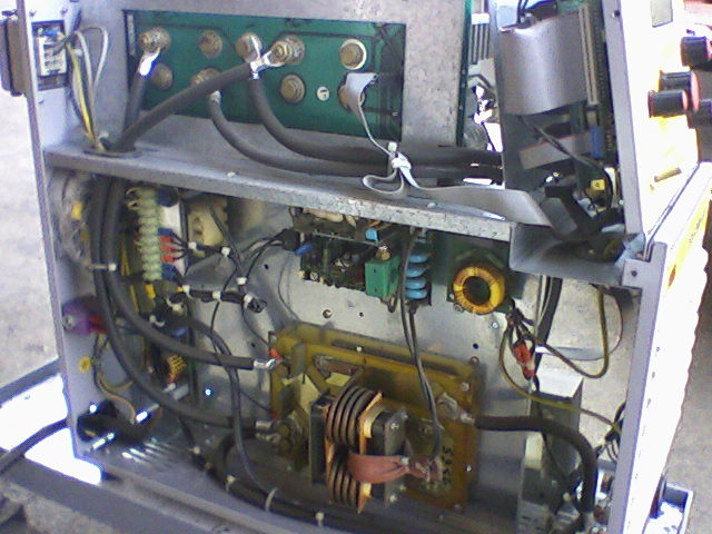

i have the same machine but 110v. recently i have had a problem with the HF start not working. it works fine on lift start but if i swaitch over to HF the arc is erratic and spluttering and i dont get the nice High freq 'Buzz'.
any one have any ideas as to what the problem could be?? i havent had time to open it up yet so any pointers as to what to look for when i get the case off would be appreciated.
