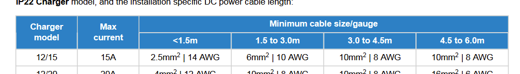

I’ve got my hands on a 15amp victron battery charger, I don’t have instructions.
I need to make my own leads up that are at a maximum going to be two meters long with an Anderson connector in the middle.
What size cable should I use please?
I was thinking ten millimetre but is that a tad overkill??
Thanks.
