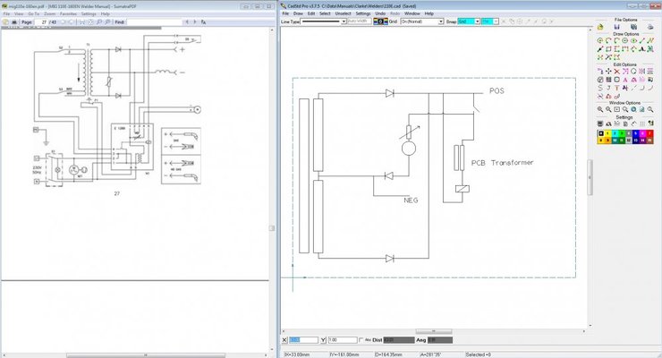

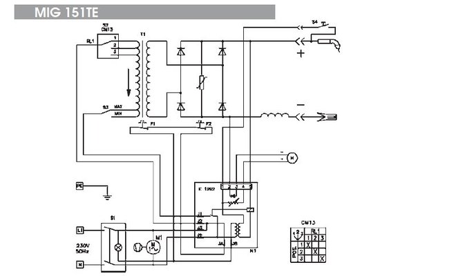

I've recently bought a clarke 151TE which came with a problem.
Without the trigger pressed If I measure from the tip to the earth lead with a voltmeter it shows about 35V. If I then press the trigger I get the expected voltage from the lowest setting to highest (16v to 35v) (ish)
The problem reported was that the wire kept on welding itself to the tip or the swan neck liner etc , which seems to tally with having full power without having the trigger pressed.
Can anyone point me in the right direction as to what I should check next ?
I've taken the cover off and cannot find any loose connections, or see any obvious burnt components on the PCB.
Thanks for any help,
Rob.
(I have a working 150te for spare parts if need be)
