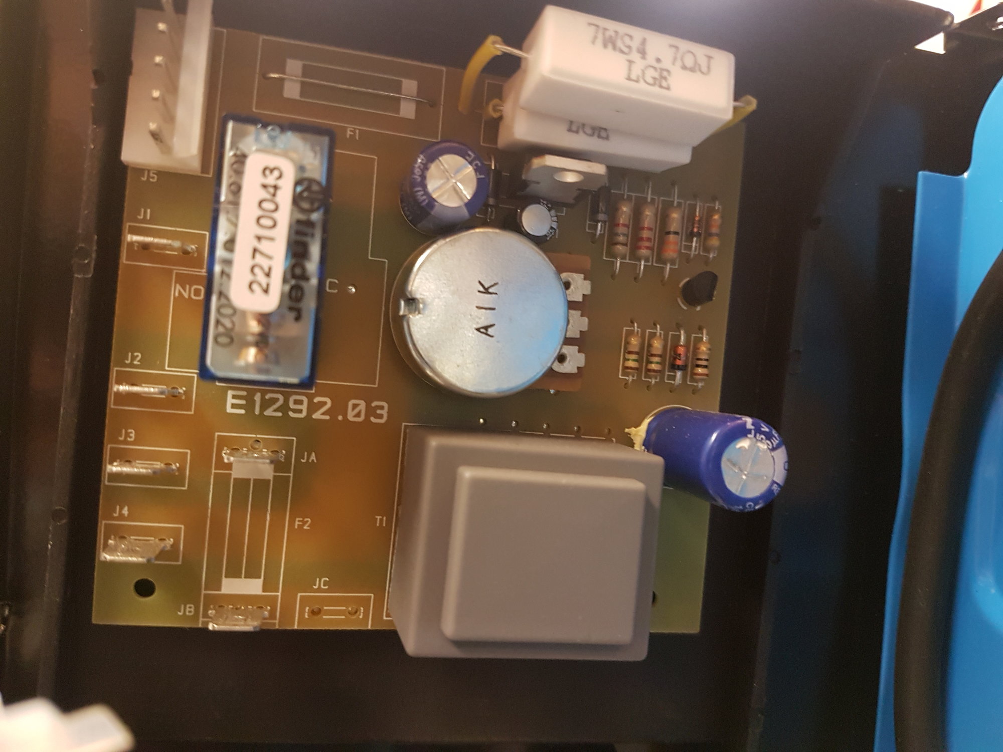

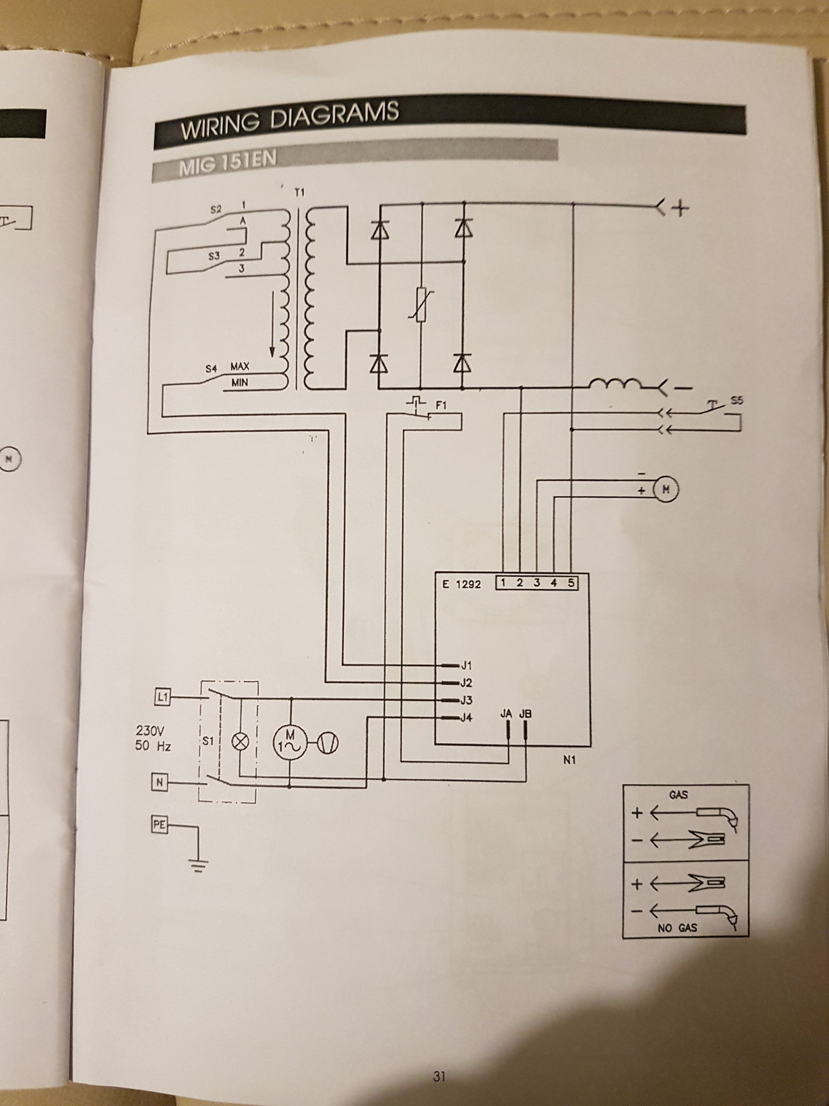

Does anyone know what voltage the wire feed motor for a 151en is? Clarke service are saying its 24v and when i take a reading on lowest wire speed to hight wire speed it ranges from 6v-26v. Which also leads me to believe its a 24v motor. But on the pcb to transformer is 12v and the relay is also 12v. Could anyone shed any light on this.
Motor is vmotor v-1030270 i cannot find any info on this motor.
