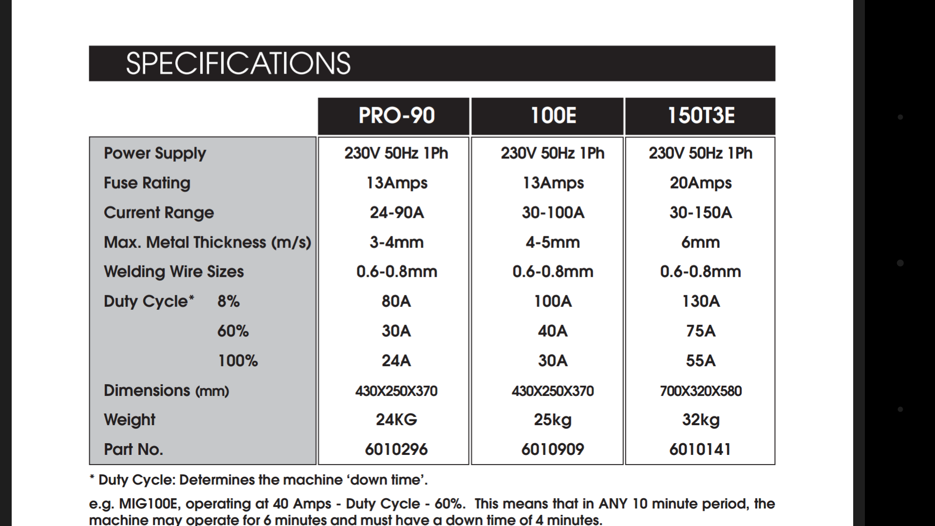

I have changed everything but feed is so jerky I don't know why.
When I use for a long time it starts stopping and then starting again.
I have changed liner, neck, tip even the roller. I greased the spindle of wire, tightened, loosened retaining nut.
Changed the tightness of the roller pressure nothing is making it work well. I am thinking it must be motor or PC board/component now.
Anyone else ever had this problem on a Clark?
Thanks
