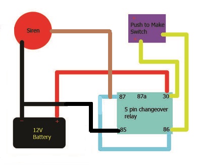

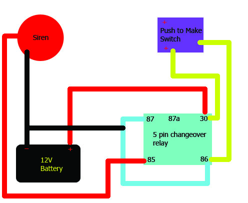

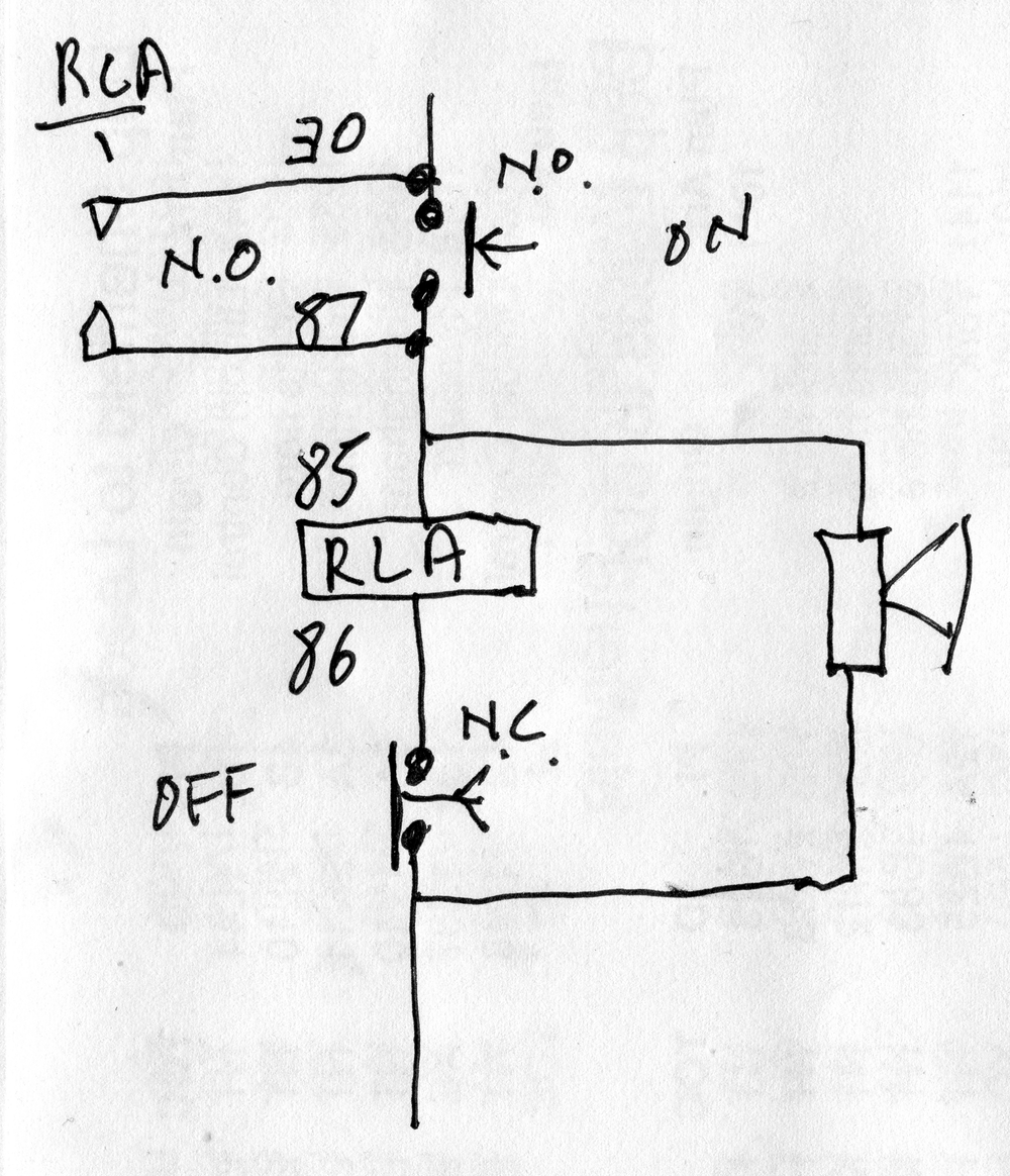

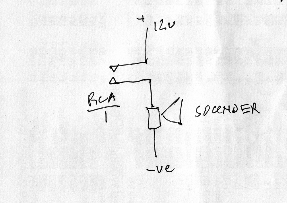

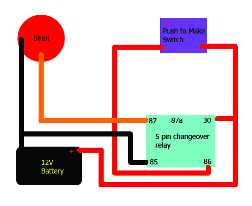

I'm trying to wiring up an alarm with these conditions:
When Push to make switch activated (+ 12v), siren to sound, but then the switch becomes
defunct i.e. Releasing the switch does not deactivate the siren.

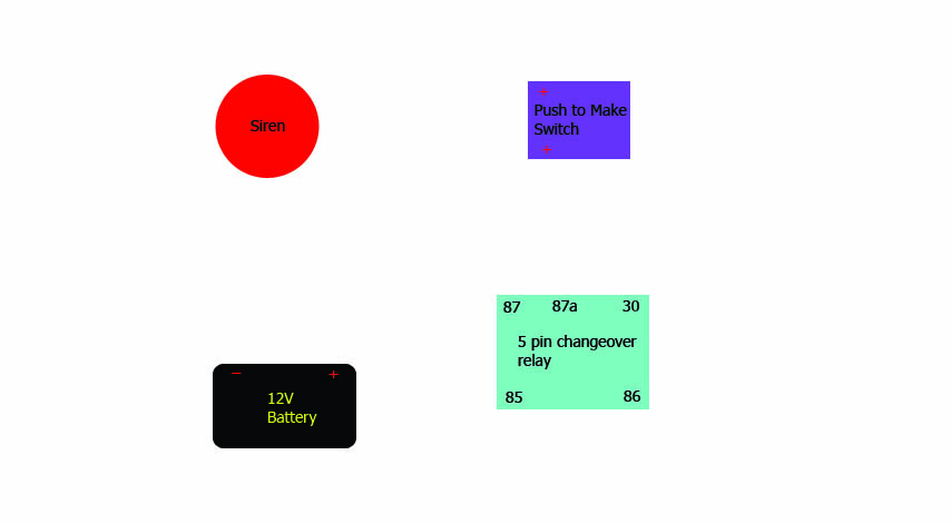

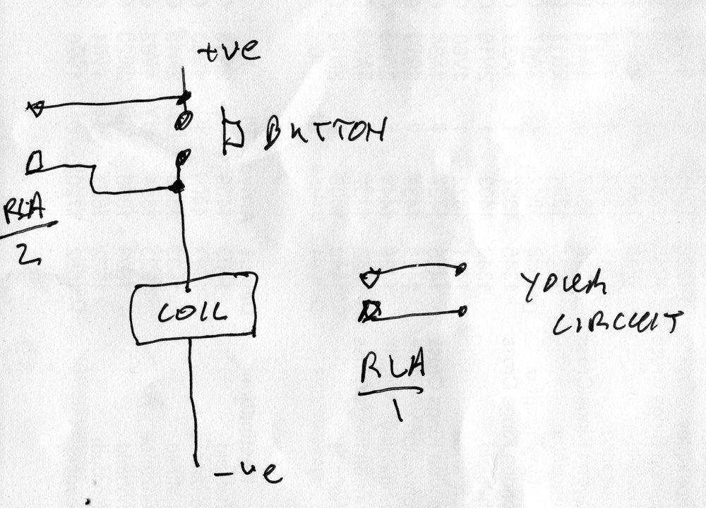

I assume a relay is the answer, but I don't know how to wire up a relay.
Thanks for any help
