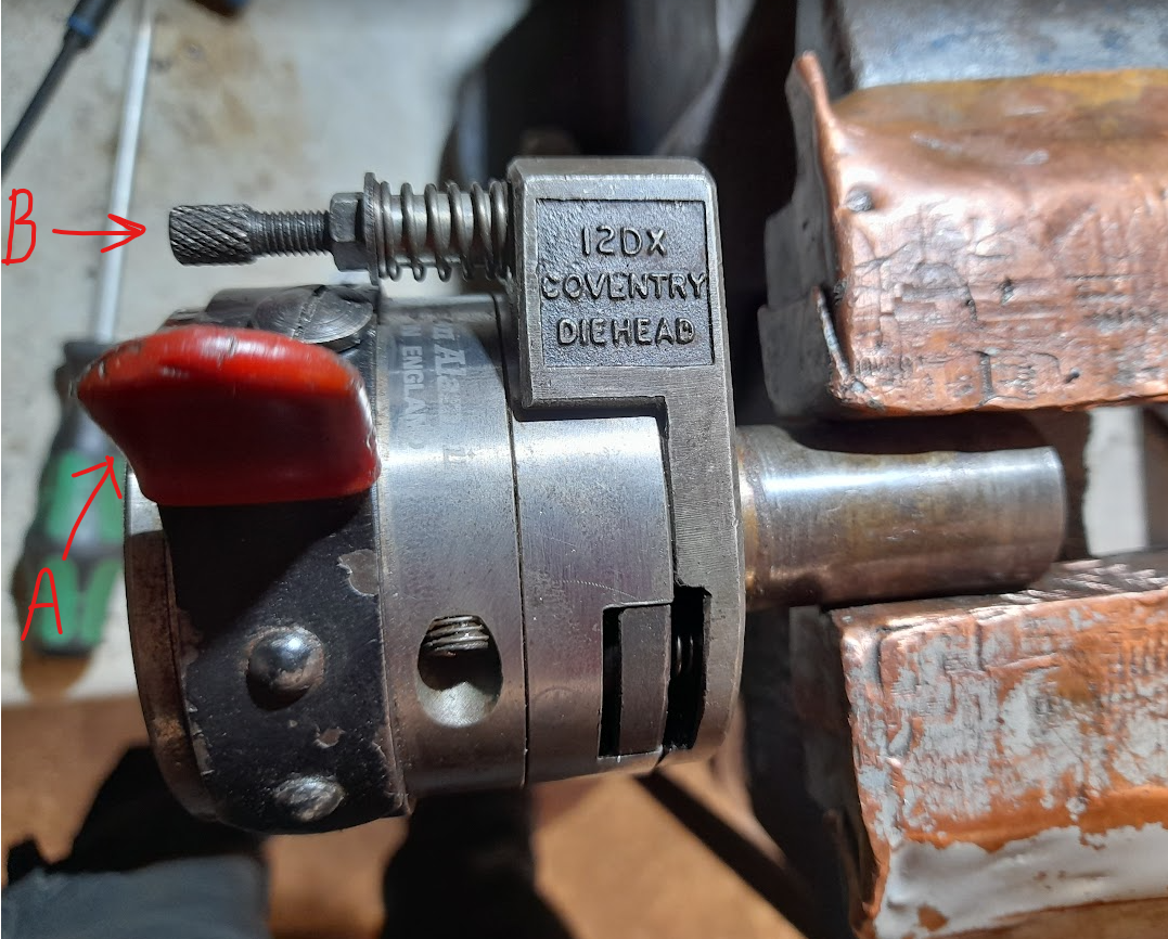

I've had this diehead doing nothing on the bench for some while and decided to see if I could get it working. I should mention that I have never used a Coventry diehead of any description, but I've watched a few videos and seen how they are generally used. I've also got "The Book of the Coventry Diehead" (96 pages) that whilst useful does not reference the model 12DX.
Upon examination the diehead was seized into the thread cutting position (dies, if I had them, would have been closed) but partial disassembly fixed that problem. I can now engage the dies/scroll by rotating the red lever (A) and it locks into position. I had expected the dies would open if the diehead was pulled forward (pulled to the left in my photo) but it does not appear to work that way. The only way I can get the dies to open is to depress the button (B).
Searching online for more information I found this web page:
https://engineering-supplies.com/sub/288/a-coventry-die-heads-dx-type-/
that includes the following text:
I'm not exactly sure what they mean by the pull-off or push-off action. Previously I would have expected pull-off to mean the way I have seen die heads used conventionally. e.g. stop feeding the tailstock/capstan and the diehead would disengage automatically. But how about push-off? Is part B meant to hit a stop?
All advice welcome.
