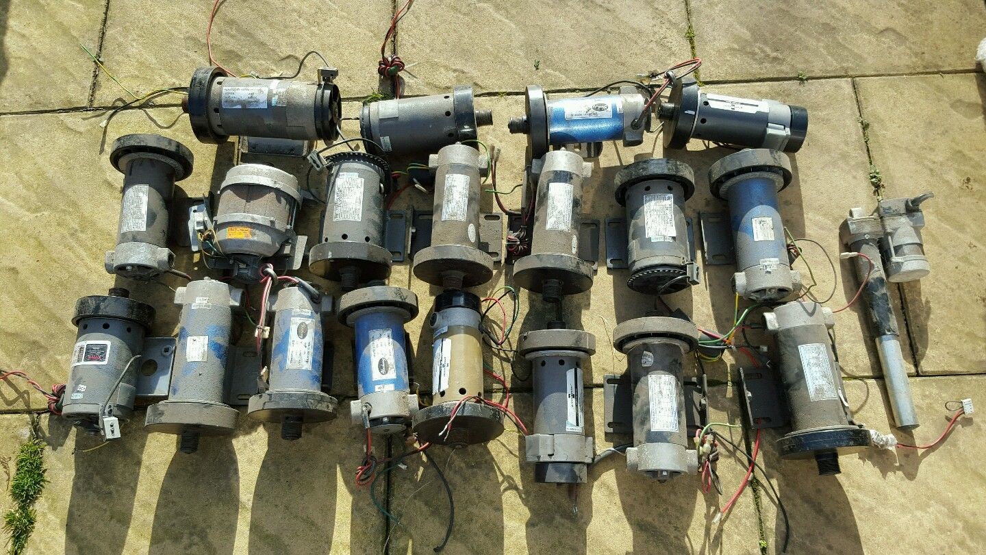

How do they work on a treadmill then...even I can walk on them...slowly.I think one of the problems with making a positioner motor from a treadmill motor is the high native RPM they have. you'll have to gear it down by a huge ratio to be useful.
With a 80mm drive roller it would be doing roughly 4 revolutions for every meter the belt rotates as you walk.How do they work on a treadmill then...even I can walk on them...slowly.
It the motor pulley is roughly 25mm that is about 3 to 1 ratio.
So every meter the treadmill belt moved the motor turns 12 times.
(hope that is close i am struggling with thinking tonight).

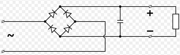

.Technically, you can't get more DC out than the peak to peak (Vpp) in, rather than peak (Vp)Yeah it's the fact that AC is talked about in RMS.
You can't get more DC out than the peak volts in, is what I was trying to say - badly.![]()
I was hoping using a lower voltage they might fit the bill...still maintaining torque.
