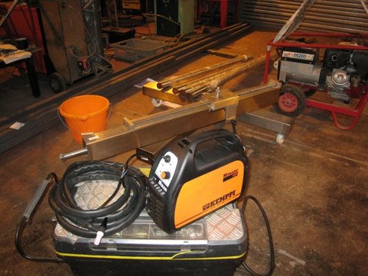

Jeez, 110V at 32A. The most you can get an meet any code here is 20A. Those are rare.
I would think a 230V/20A would be safer from a fire standpoint.
I think the 110v we use on sites is different from your 110v supply.
Its from a transformer which gives 110v, but its 55v+ and 55v-
