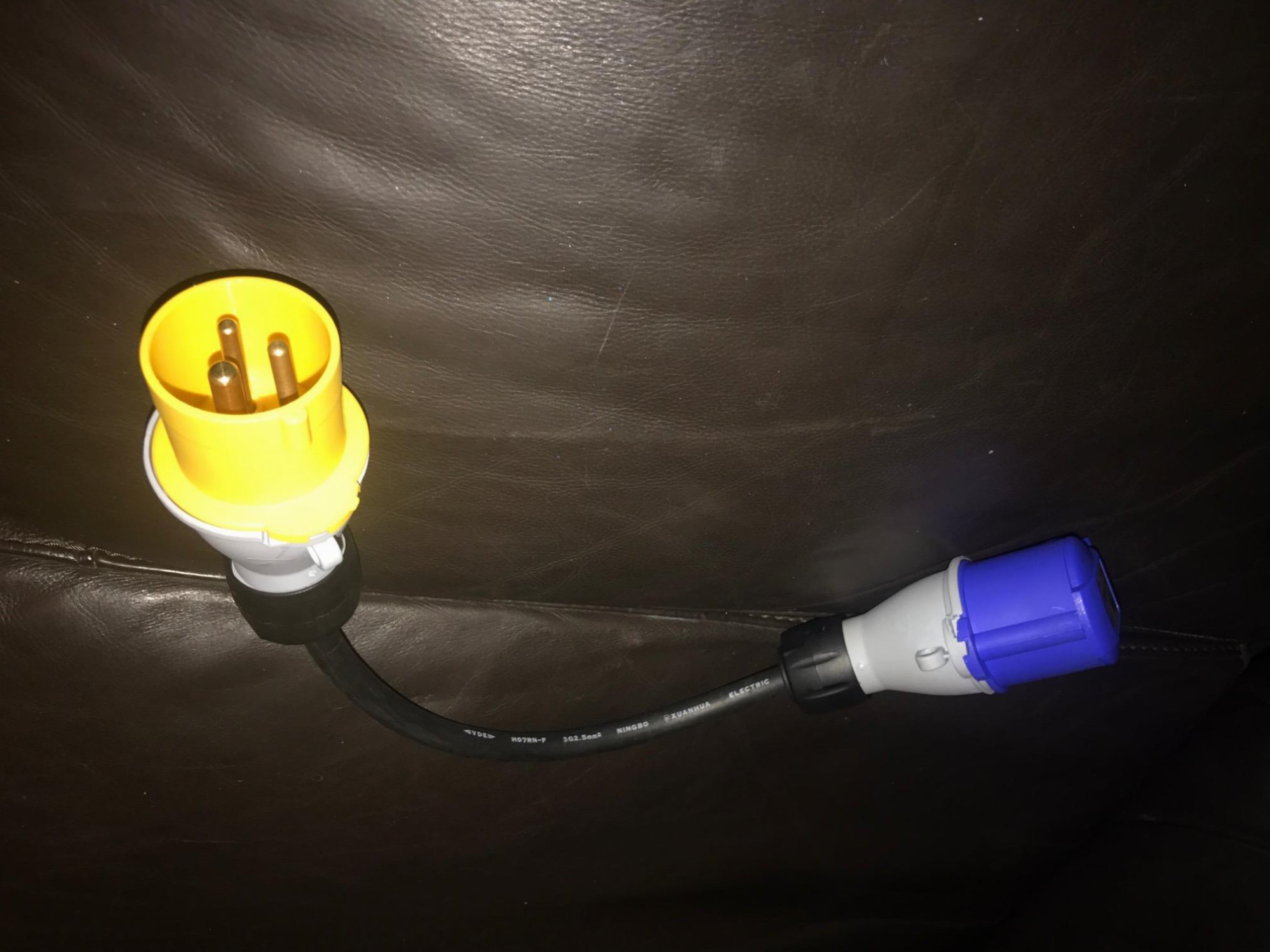

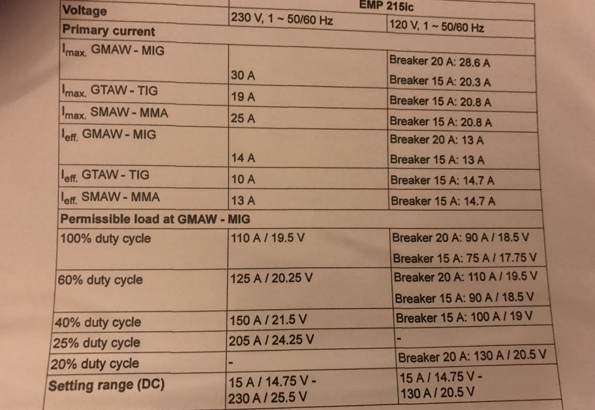

apparently the Esab Rebel can run on 110v and 240v.
I have it set up with a 16a blue plug that I plug into a 16a socket that has a 13amp plug at the other end.
Now, my thinking was, if i had to run off 110v for any reason, all I would need was a short fly lead with a yellow 110 plug at one end and a blue 16a socket at the other. I would then plug the welder 16a plug into the 16a socket and the yellow plug into the site supply. I think that makes sense.
Do you think this would work ?
