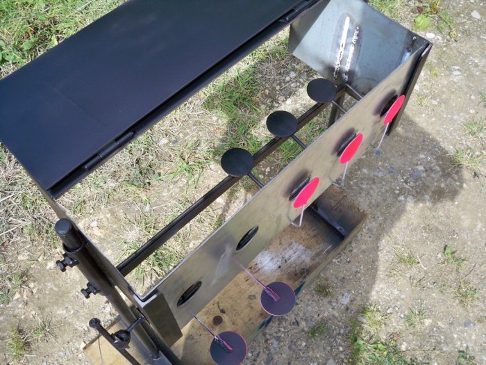

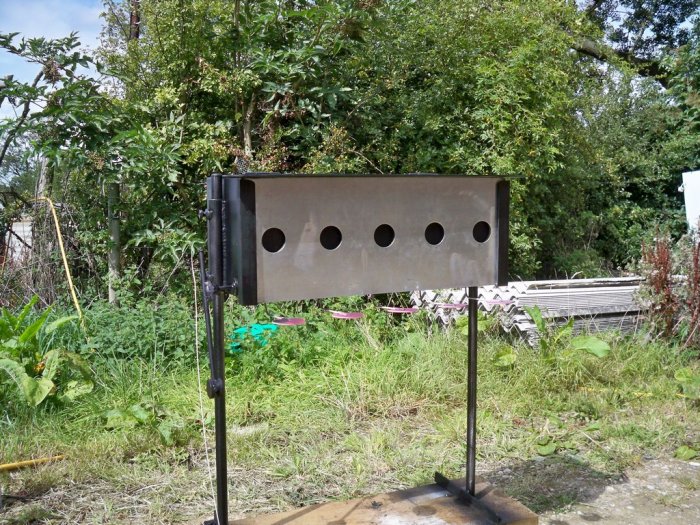

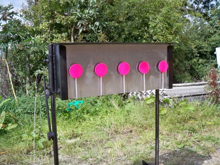

Hi all ,here's a 10m pistol target i made for the club i'm a member of , you aim at the hole and if your on target the pink disc's pop up in front (2nd photo), last photo shows some of the inside to give you an idea of how it works,after you have shot them all you pull on the wire to reset it , there is four plates with different size hole in that side in the front where the angle iron is to increase the difficulty right down to 10mm .

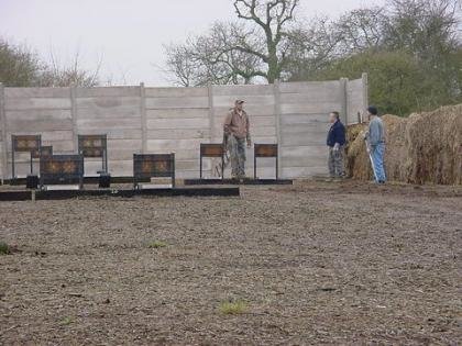

haven't got any pictures of the full wall plus we painted it green to blend in a bit better.
