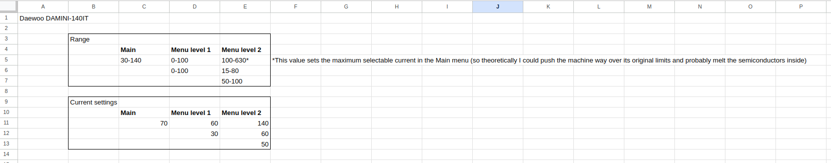

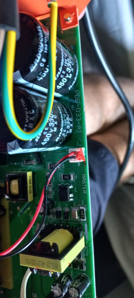

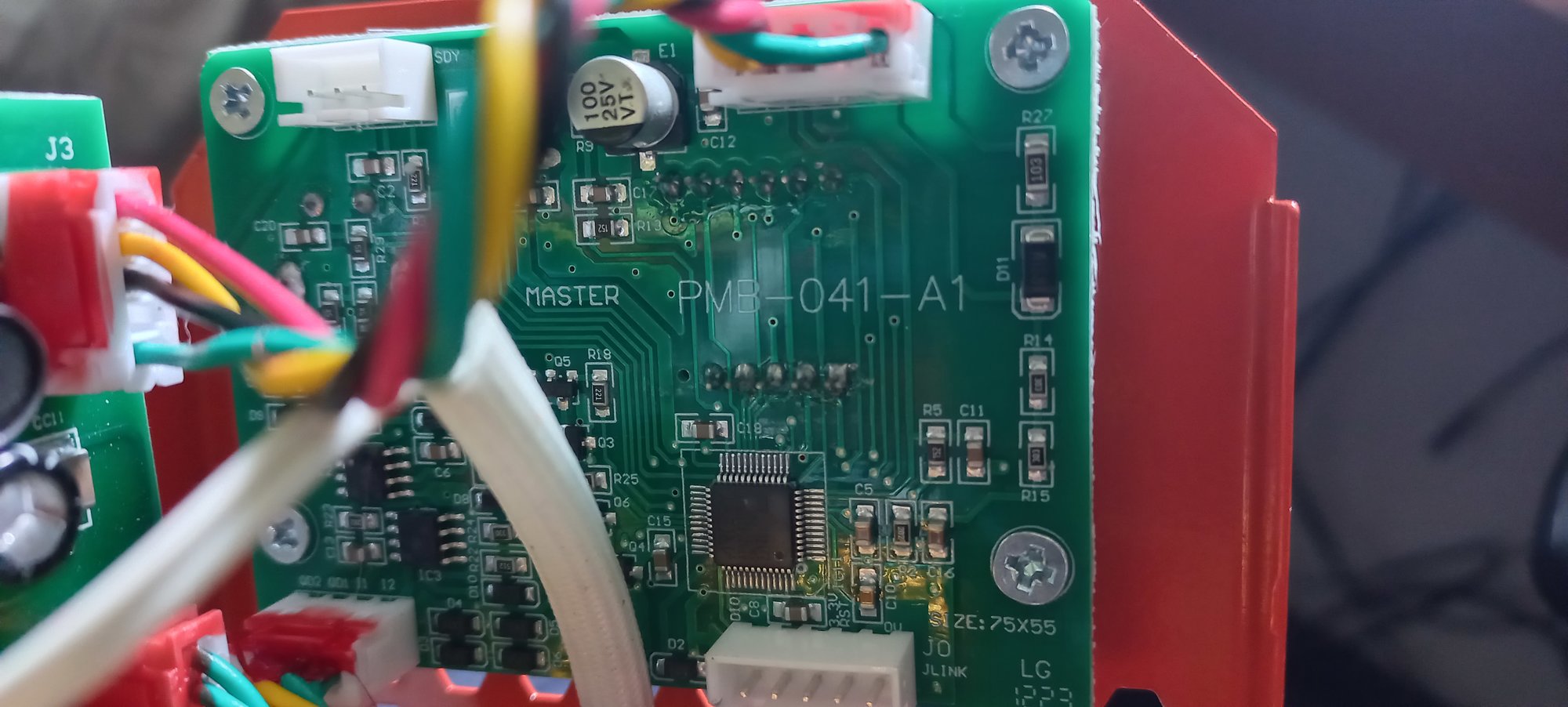

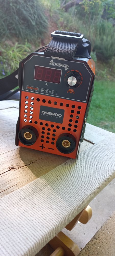

I just bought a Daewoo DAMINI 140IT machine. At first glance, this machine is a simple generic 1-knob machine. However, when I tried to use it, the welding process was terrible, it was hardly even capable of igniting an arc. As I tried to debug (check contacts, power cords etc.) I discovered that the machine has a pretty detailed menu system. The first level is achieved by pressing the knob shortly which selects a setting that is adjusted by rotating the knob. After a few seconds, the machine saves the settings and returns to the main current selecting option. The second level is reached by pressing the knob fairly long (~3 secs). After playing with some random parameters the welding machine started to work better however I have just the slightest clue what the settings stand for. Unfortunately, the machine's manual doesn't mention anything related to these settings and the manufacturer doesn't reply to my questions.
Does anybody have a tip or experience with a machine that somewhat resembles my description? I guess this machine makes it possible to adjust the hot-start, arc-force etc. settings. I have checked a lot of MMA machines' manuals but I was unable to gather any information related to my problem.
