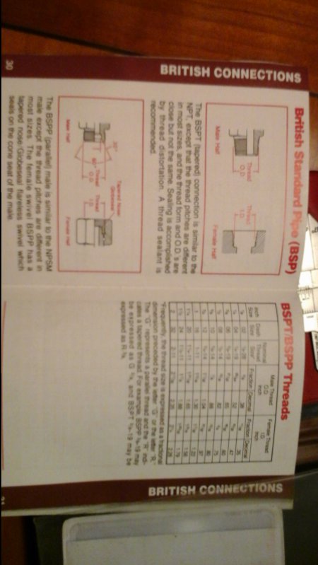

Rig Pig Member Messages 3,741 Location Narrwich! U.K. Apr 1, 2015 #11 a picture saves a thousand words! Sorry about the quality, my Samsung tablet camera isn't the best.
M Mr shiney Member Messages 1,241 Apr 2, 2015 #12 Rig Pig said: View attachment 62723 a picture saves a thousand words! Sorry about the quality, my Samsung tablet camera isn't the best. Click to expand... Thanks, i can just about read it.
