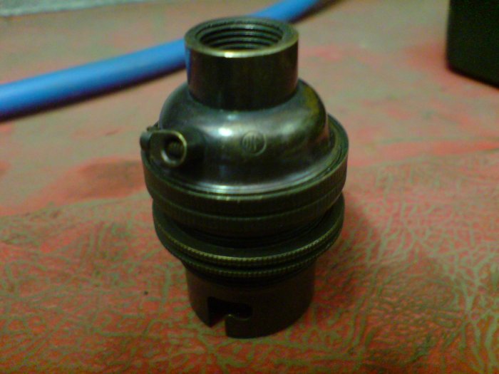

I'm trying to find out the thread size on a bulb holder for a domestic lamp. The bit where the holder screws on to the lamp stand.
It's 1/2" inch diameter female thread and only about 5 - 10mm long so i'm finding it difficult to "read" the thread gauge.
It seems to come somewhere between 27 and 28 tpi, but i'm finding it difficult to pin it down exactly as the difference is so small.
The packet it came in said 1/2" BC. From what i can find out the BC refers to the bayonnet fitting.
The closest thread i can find is 1/2" British cycle thread (26 tpi). Or is that what the BC on the packet is refering to ?
Any ideas welcome.
