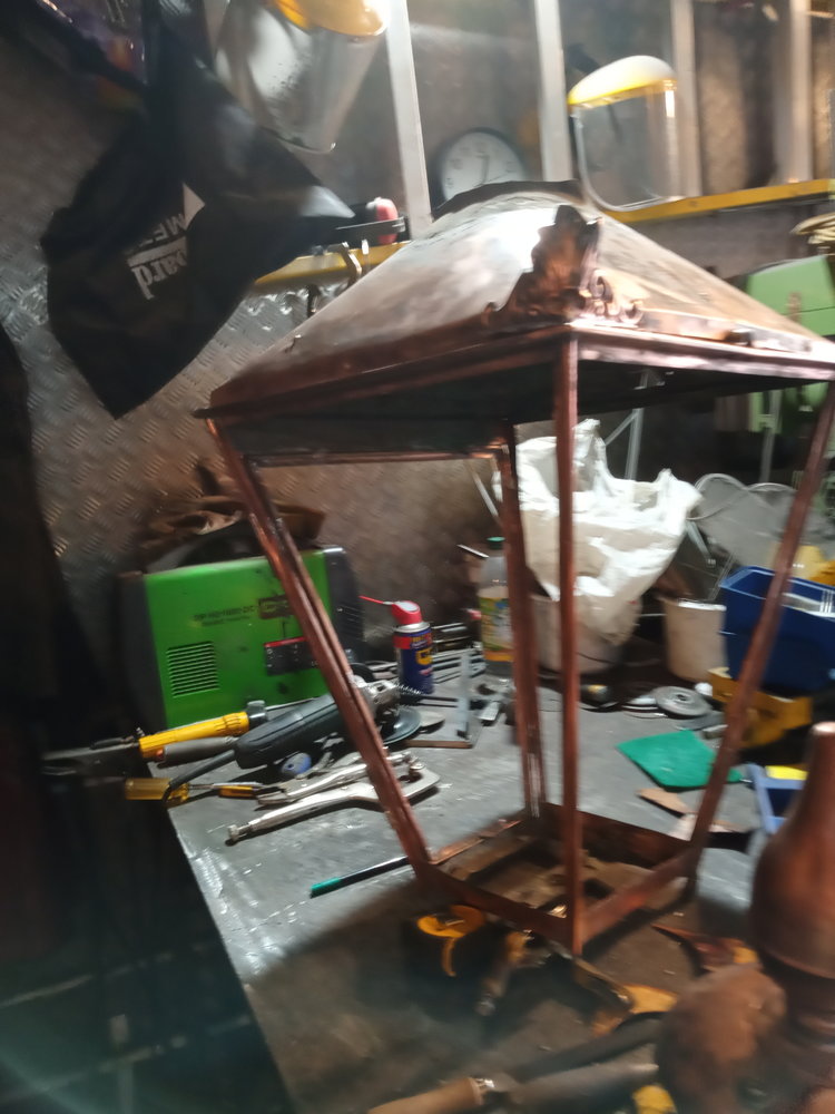

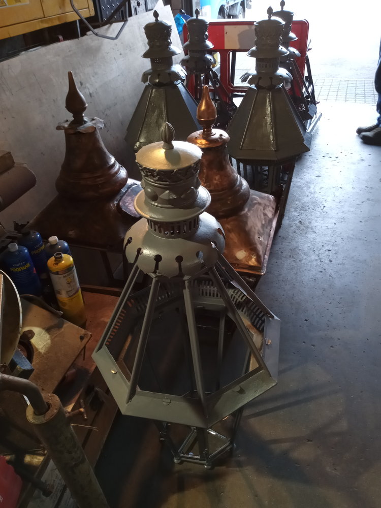

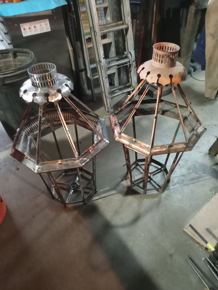

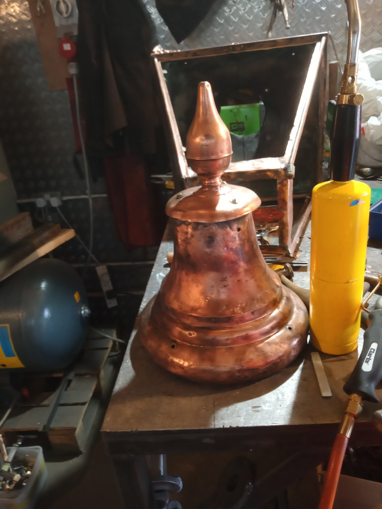

Got some lanterns to repair, copper mostly thin.
Soft solder works on some bits ( though limiting it to lap joints)
Silver solder works but not really localised enough for some areas.
Tried Tig briefly which looks like the way forward, any other methods anyone favour?
Thanks in advance.
