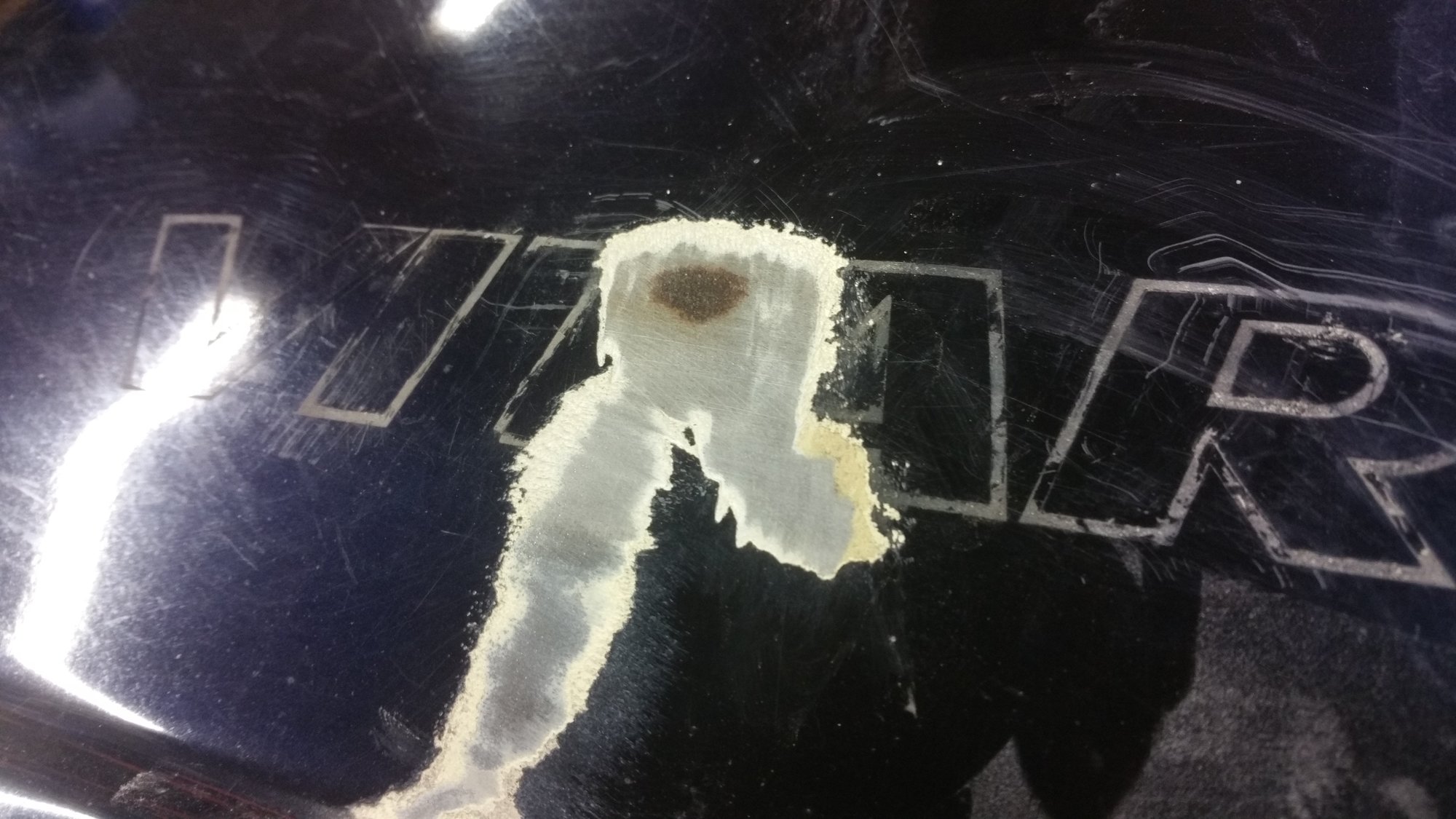

Started working on my doors today, stripped the locks and windows off them, then pressure washed them and started removing the old seam sealer.
Spotted a spot where the paint had failed with bulging from rust, so got out my bristle blaster to see what's going on under it. Turns out the paint on the door is 0.53mm thick all over. It's not poly filler, it's a thick layer of some white stuff.
The rest of the car has regular ~0.15mm thick paint. What's going on here? Could the factory be putting on thick filler coat on doors to get the profile right?
Looks like I need to strip the doors as the paint has failed in quite a few places.
