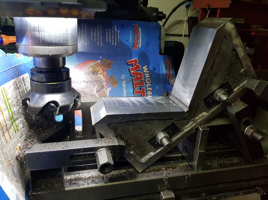

Big v blocks almost finished , all sides milled square now and finished the angled part after a bit of head scratching on how to mount it to get both side equal angle and height . Just got to drill and tap top clamping points then mill out the slots where i can bolt it down to the table. Almost another project finished just got to actually finish it and not start something else !
